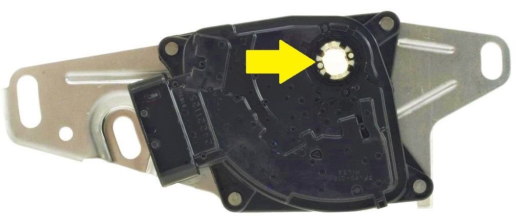

The PRNDL switch controls the ignition cylinder lock. If you are unable to remove the key, the transmission is not in park. Get down and dirty and make sure the transmission shift lever is in P(park) + check the PRNDL switch while you are down there.

do the gears match on the dash with position of the shifter? if they do not then the cable has issues or the range selector switch or it's plug / wiring is having issues
