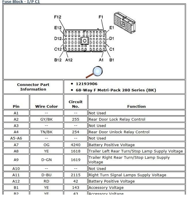

This is a high current circuit feeding +12V power directly to the Wiper Motor & Pulse Module, the associated Ground G203 is on the Lower Right side of the dash near the right kick-panel (seems unlikely to be this)
The WS WPR 25A Fuse in the I/P Fuse Block (lower left side of dash) so it's more likely to be a bad connection, a bad crimp or connector?
It seems the I/P Fuse Block can be unplugged (no experience on this) with a big 68-Way Connector (C1) at the rear, Pin B1 (circuit 143, Yellow, "Accessory Voltage" ) being the associated wire (see PDF)
I'd be tempted to give block and it's wiring a bit more movement, the meter effect could be a red herring.
