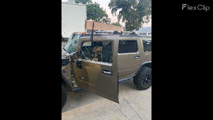

Want to report that I changed the driver door pins. it is a pretty easy job here are the steps I took,
  1. Support door from upper window frame window open,
  2. Remove Vent cowl end as the door hits it if you lift it off the pins like I did.
  3. Remove bolts off door limit/indent strap (door center) and the lock bolts on the hinge centers, Lift door off pins make sure it hangs close to body frame
  4. Mark with sharpie the alignment of the bolts against the hinge on the body frame side, it is the only side of hinge needed off for the repair.
  5. Remove hinge lock bolt then the 5- bolts holding the half hinge.
  6. Compare the replacement parts to make sure you have the correct kit.
  7. Cut the pressed in heads of the pins (not the pin) with a angle grinder
  8. With a center punch pound out the pins off the hinge lock and remove the worn bushings
  9. Install the new bushings, place new pins in place and tighten to press the taper back into the holes.
  10. Once the pins are pressed into place loosen the lower nut slightly to unbind it.
  11. Reverse the hinge removal steps to reinstall.
  12. I did one hinge at a time, but pretty sure both can be off at the same time.
I can tell these will need to be kept lubricated to keep the bushings from wearing out to fast.
