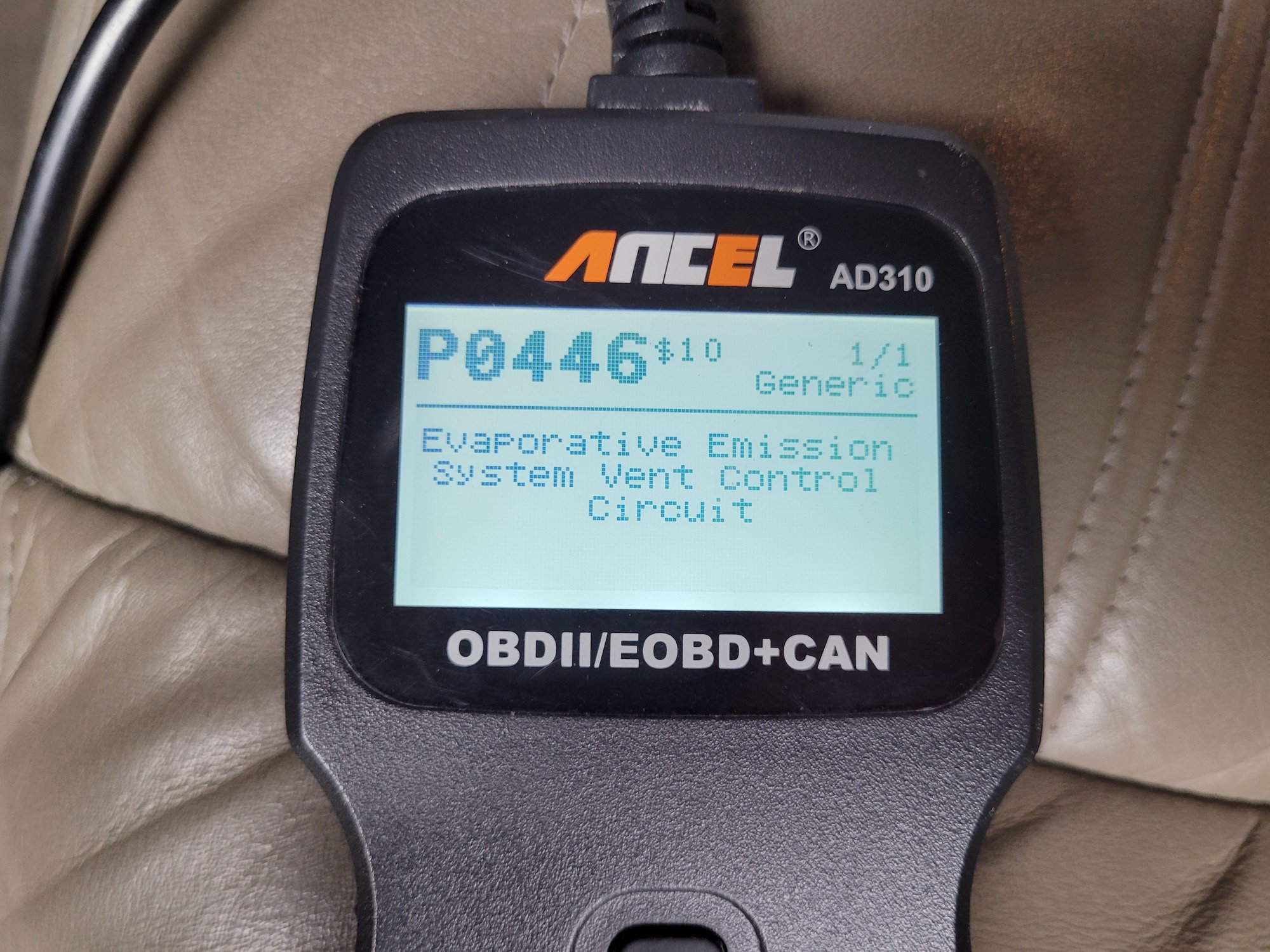

I have been dealing with the P0446 code for months. It is for Evaporative Emission System Vent Control Circuit. I have replaced the Vapor Canister Vent Solenoid Valve 25932571 twice (I also checked the wiring on the plug and didn't see any problems), the Evaporator Emission Canister Purge Solenoid Valve 12581282 twice, and the Vapor Canister 22963841. Each part I used genuine GM and not Chinese knock offs. I clear the code and it will come back after a couple days. What are the next steps? I have not tried replacing my gas cap but when I inspect it, it looks fine as does the rubber O ring on it. Sometimes when I pump gas it will cut off, but it will eventually fill up without issues after I readjust it a few times. There is also a fuel tank sensor I read about to possibly replace but that seemed to be for a different code. Is my next step to blow out the evap lines? If I need to blow out the evap lines with compressed air can someone please explain it as if I were a 5 year old? I don't want to screw anything up. What line do you put the air through and which lines need to be disconnected? Does the fuel tank need to be dropped to blow the lines out? Any help is greatly appreciated!

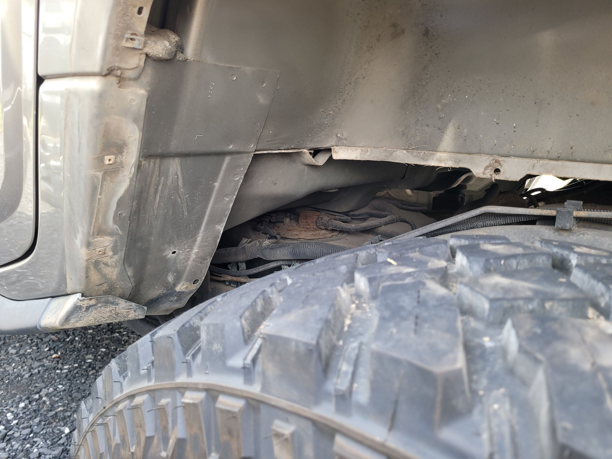

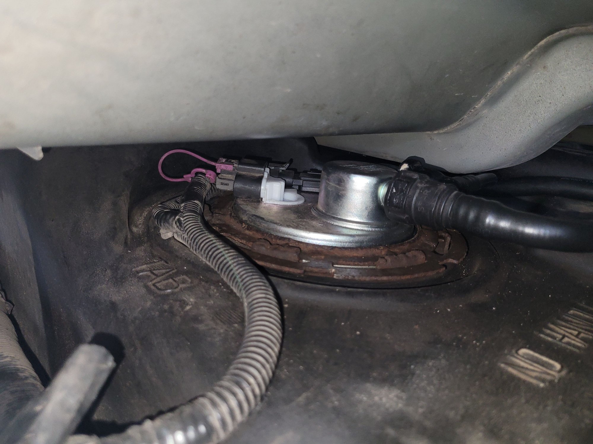

UPDATE: So I went to replace the fuel tank pressure sensor, as it was basically the only thing left I hadn't replaced for P0446. My fuel pump was so insanely rusted that when I tried to take the sensor out, it snapped in half leaving the rubber grommet part inside the pump. There is barely enough room to fit your hand in there after taking off the wheel well liner and fender flare. There was no option left but to replace the entire pump, which made sense anyway as it includes the sensor and my pump was rusted to hell. The check engine light is now gone. Posting this update to help others chasing down this annoying evap code.
