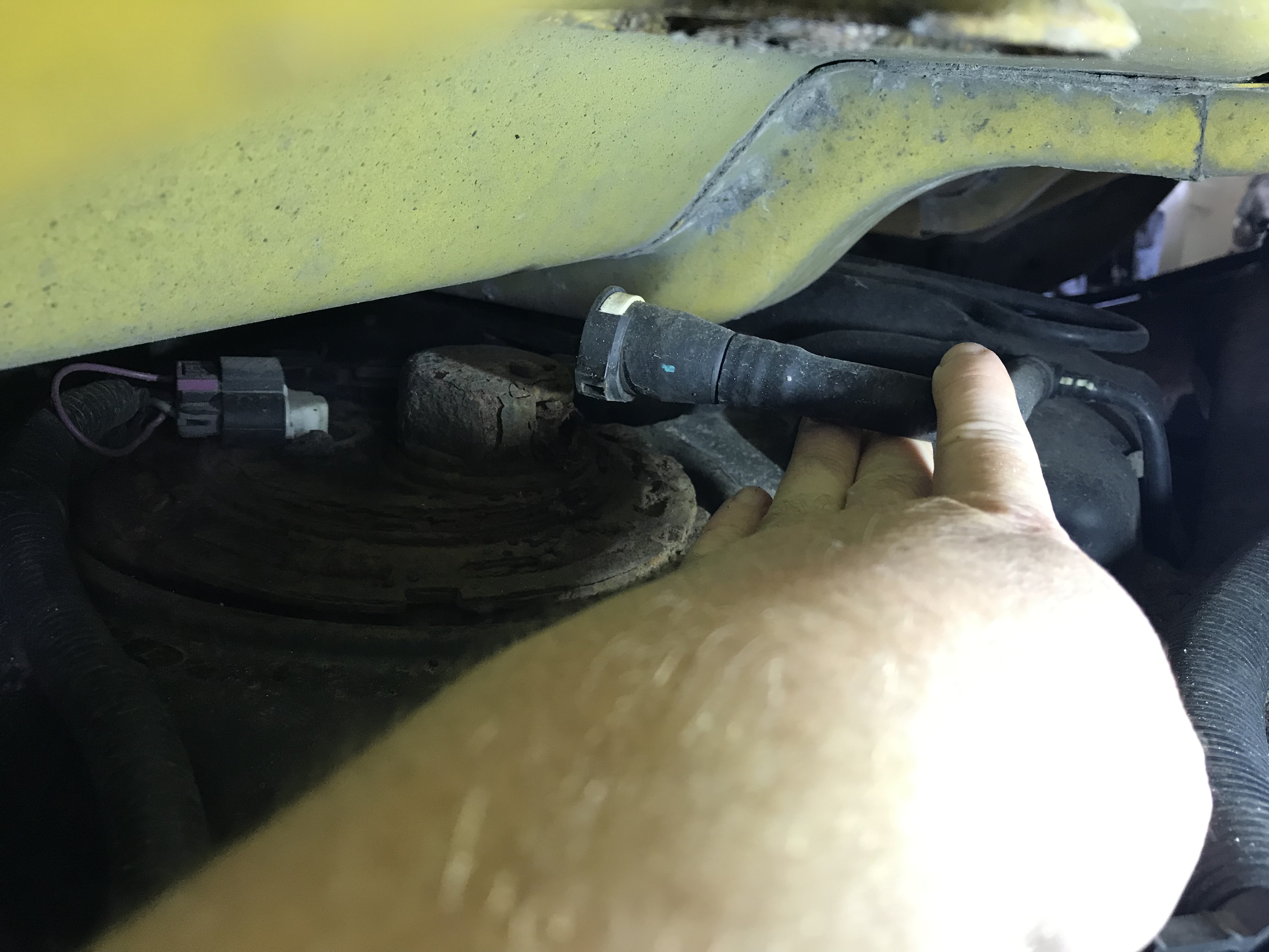

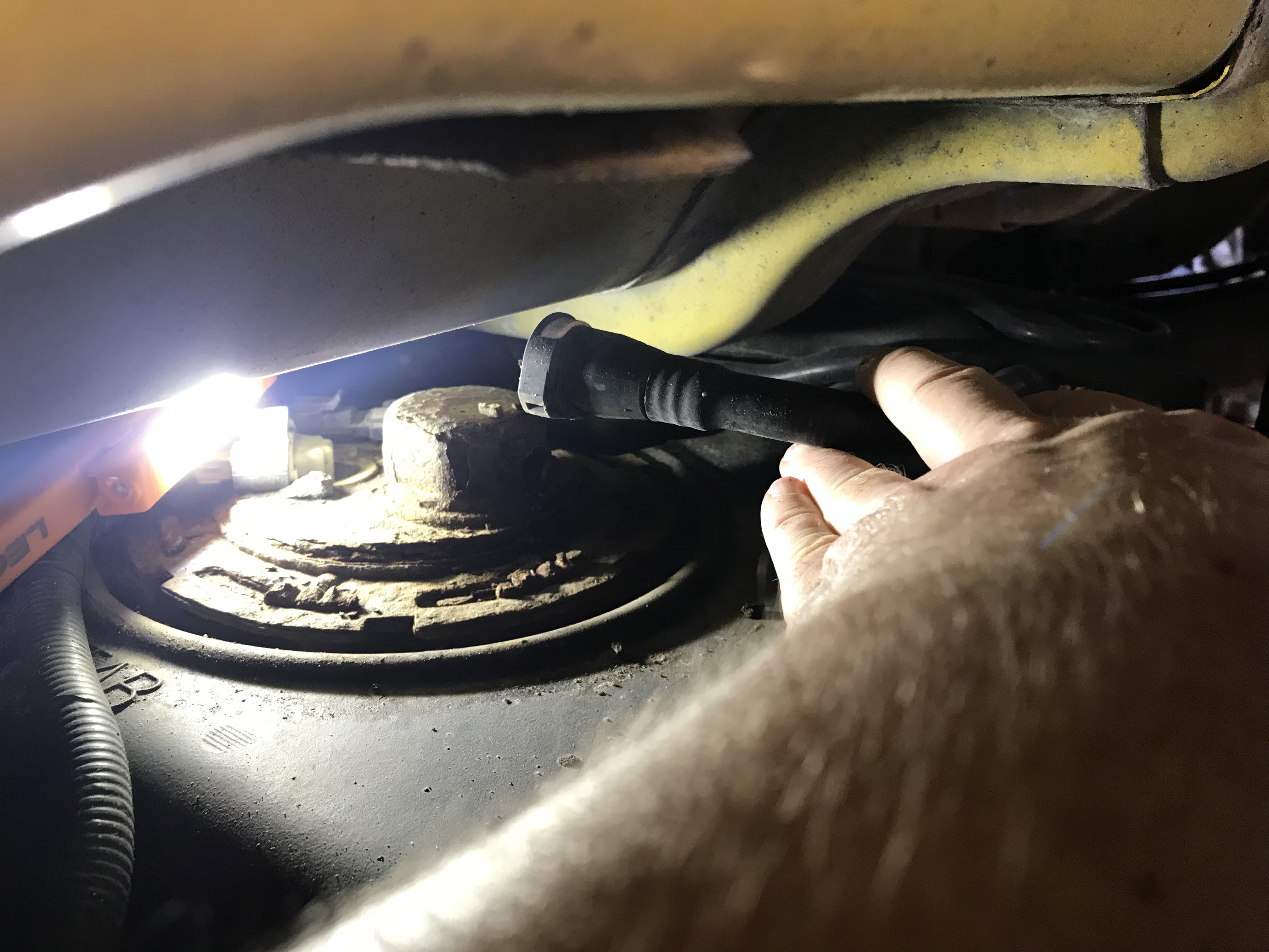

Sorry. Work has me so busy I can’t see straight. So I was trying to see if I could smell gas. I’ll be honest my sense of smell sucks... I thought I had gotten a wiff of gas fumes a few times before too so I am actually in the middle of pulling trim off to get some body and paint t work done. Well with the rear driver side wheel well I can see easily on top of the tank. It looked s little dark on the far side so I thought I’d see if it felt wet... well as soon as I touched the vent on the pump it fell off. The pump is rusted right through. This is most likely the problem. I know I have seen others stating same if the forum and on line.
Going to order a new pump and locking ring. If I remember right there are 1 or 2 sensors on top of the tank. Can anyone get me a part number or name? I’m searching for them. Might as well replace them too while I have the tank down.
