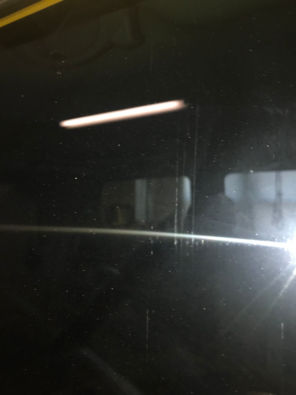

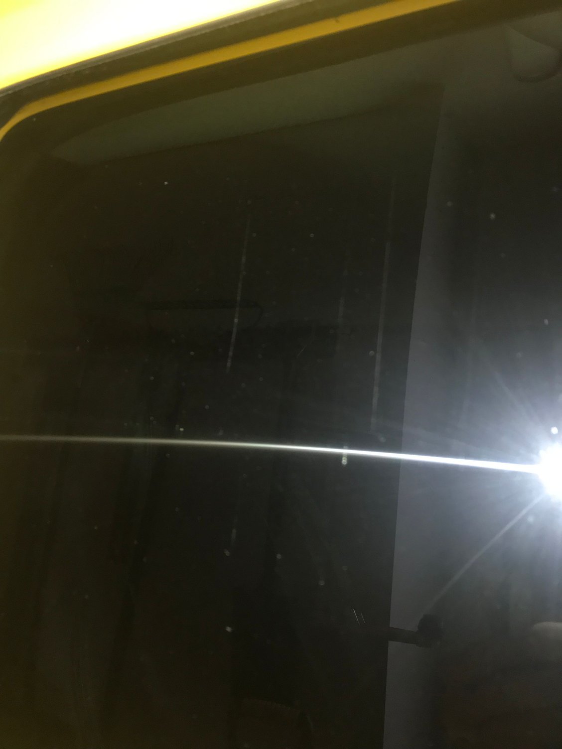

Hey folks, I have a question. I’m currently trying to clean up a new to me H2 (my 3rd one)... my last one was broken into and I decided to replace over repair. My question is about the door glass... my current one as well as my last one have faint vertical scratches on the outside surface of the glass. I am going to inspect the window felt but I don’t thing it’s bad. Is it just a common thing with years of usage? Do you folks also have scratches? If I use a flashlight on the glass I can see them. I am considering a replacement of the door glass... or I may just deal with it a while longer since it’s not al that bad. I’ll post a few pics. I noticed it yesterday while removing the window tint from the front doors.

I'd say this is more common on vehicles that have been properly off road and slinging mug.... but really any vehicle will tend to have some, especially if its older. The reason as you mentioned it obvious. The outer window felts can and will get fine particles embedded into them over time. Moreso if mud has been slung all over the sides of the vehicle at times. As I get older and my vision inevitably gets worse it becomes more and more noticeable to me as well with the glare that it adds. Especially on the windshield since that is where I'm looking out most.
2 fixes. Replace the glass of course is one. The other is to polish the scratches out. Very doable if they are not deep. If you have some so deep that your fingernail catches than you are not likely going to be able to polish them out. You could then either have a glass repair place fill them or replace the glass.
Polishing does work well though. You want a cerium oxide based polish. Powdered cerium oxide and mixing it yourself in combination with a decent sized pad on a drill or rotary polisher work the best. Another that also works well for a pre-mixed solution is ceramic/glass cooktop polish...
The are plenty of products out there though. Look on Amazon and search online some for polishing scratches in glass. Plenty of tips and tricks.

I have scratches on all of my side windows, and they are pretty significant. I used to park under trees. I think mine were caused from crud getting stuck in there when not driving the truck for a few weeks at a time. the felts look fine when I inspected them. It drives me crazy.

At 65-70 a glass I may just replace the glass. I did take a peek at the felt and I can’t see anything obvious. I have been cleaning sap off if it and pine needles (it’s covered) so I suspect that to be the cause. I plan on keeping this one for a while, so new glass may be the easiest route... the scratches are mostly light but a few catch my finger nail. What I may do is check the glass closer and if one is all only light scratches I’ll polish it (if it’s cheaper than 70.00) if it catches my finger nail I’ll just replace it over time.

I pulled the door glass back out this morning. I took a close look at the outer felt window strip and I can see some corrosion on a few of the pins that hold the piece to the door. I’m wondering if that could be a cause for the scratches. Unfortunately while pulling it apart I messed up my back (2 back surgeries in my past)... so I wasn’t able to look further. I think if I clean it all up they will be fine but I wanted to share that info. I’ll get pics tomorrow when my back is behaving a little better. The felt strip looks fine over all. Just the clips inside is all I was able to see. I’m ordering both front door glass later this week. I’ll clean it up and toss it back together. I was also considering adding a felt strip to cover the inner part where the pins are (pics to follow so you know what I mean). Once I’m satisfied I will do the rear doors too.

If you're referring to GM 15192121 or 25805145 (https://www.ebay.com/itm/232409591550) then those 'pins' are tucked in to an inside bend of sheet metal within the door. If installed correctly, they should not be exposed or touching the glass regardless if they are corroded or not. You can confirm proper installation after you have installed the glass and rolled the window all the way down leaving the inside seal off and gently pulling the glass towards the inside of the truck to reveal proper installation of the outer seal.
