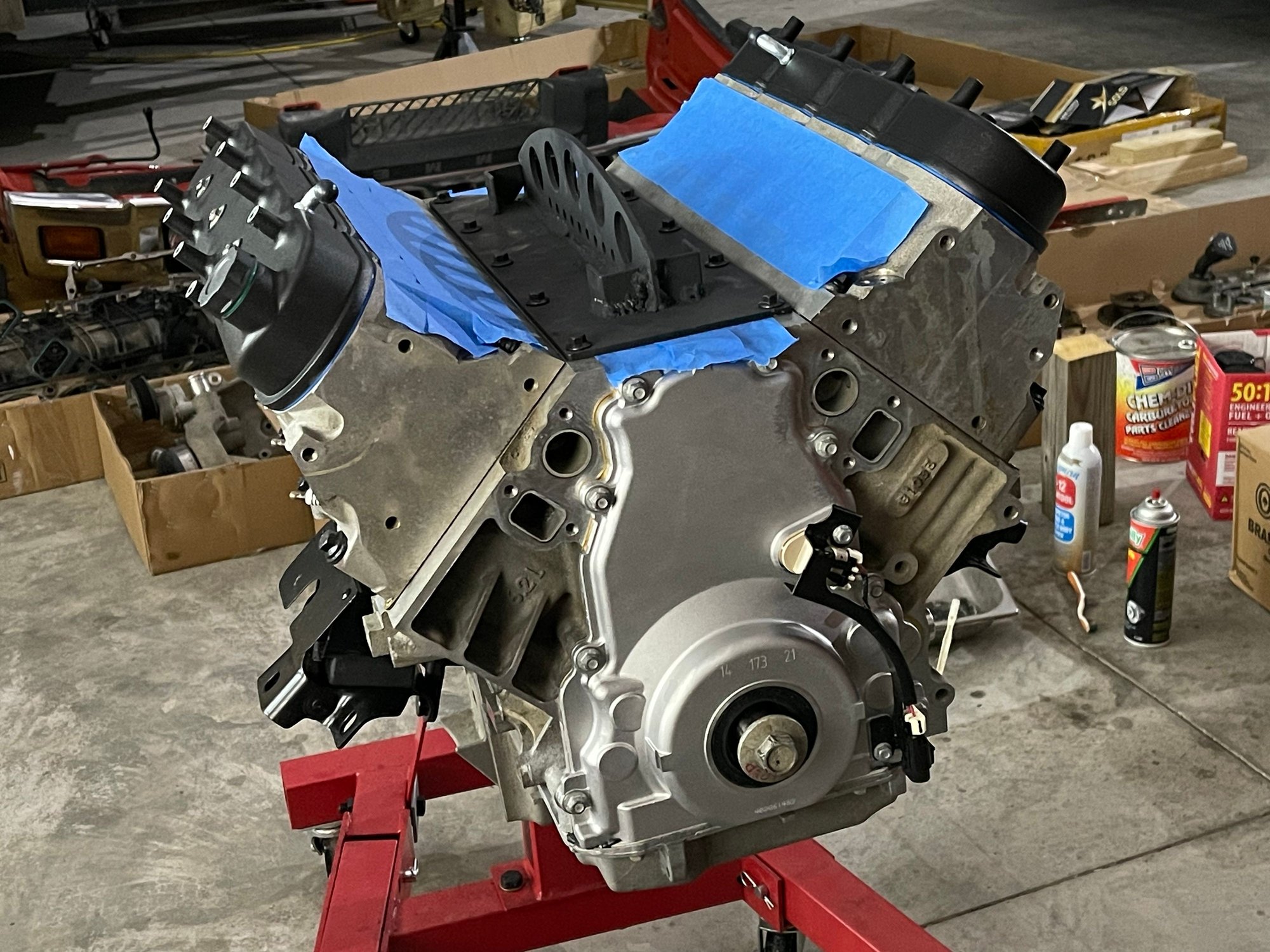

I just went through my engine in my 2009 and replaced what was needed and cleaned everything up like new. I put in a bigger cam and some valvetrain stuff to work with it. This is my wife and my retirement vehicle as well and I’m still fixing things too. I replaced the lifters but I’ve built LS engines before so I knew the lifters can still be full of manufacturing junk so I disassembled each one, cleaned and put back together first. Important step to do. Hopefully your problem clears up with some oil changes. Funny, we just sold our ESV because we decided to get the H2 to replace it. Wife loves it, Her all time favorite car!
I used blue tape too.
