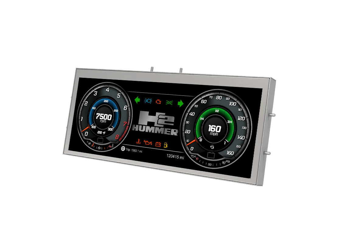

Thanks for the docs. I have most of the information already. Getting closer to a completed prototype. Stay tuned for video of display in action!

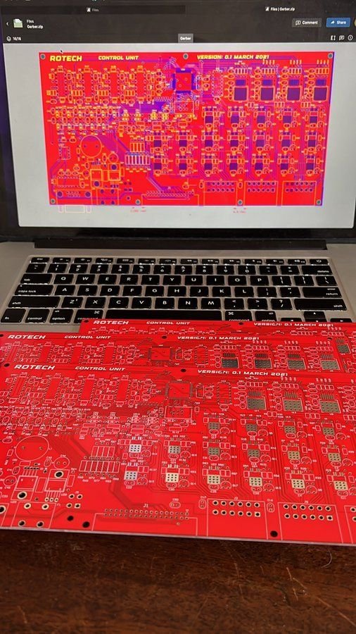

Everyone has their own preference. I have a iOS application (https://apps.apple.com/us/app/multid...d/id1436306300) I can place on an iPad to read/clear DTC's plus vehicle data which would cost far less just creating that software. I have an idea for an updated center stack screen using an iPad 10.2 inch connected to hardware I've been working on since 2021 to control all aspects of a vehicle.
