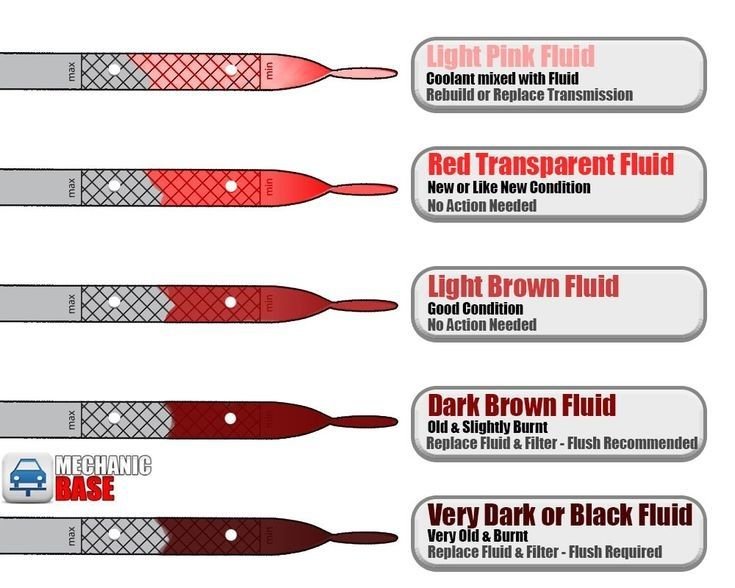

Stuck solenoids are easily restored with TRANS TUNE!
+Proper maintenance is the key to longevity!
++Monitor fluid color for fluid & filter change and/or flush to restore clean DEXVI fluid!
