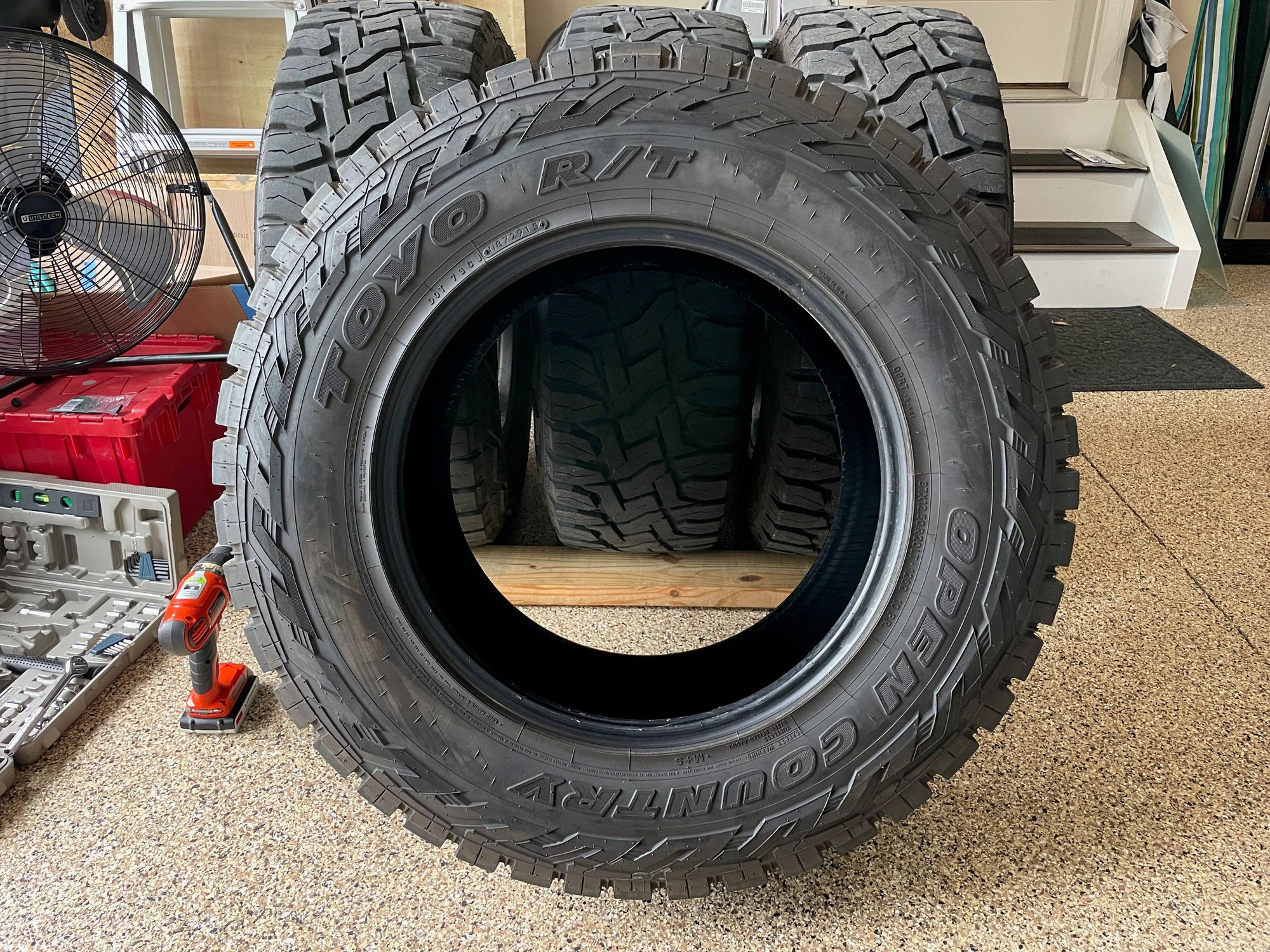

thanks Hummerz for explaining Will 37s be to big for the H2? There class D. an hold up tad over 3525 LBs so x2 is less than the total weight of H2.
37x12.50R17LT
https://www.toyotires.com/product/open-country-rt/
not planning on driving this H2 much at all. How do these look?
https://www.facebook.com/marketplace/item/1138389540691286/?referralSurface=messenger_lightspeed_banner&referralCode=messenger_banner

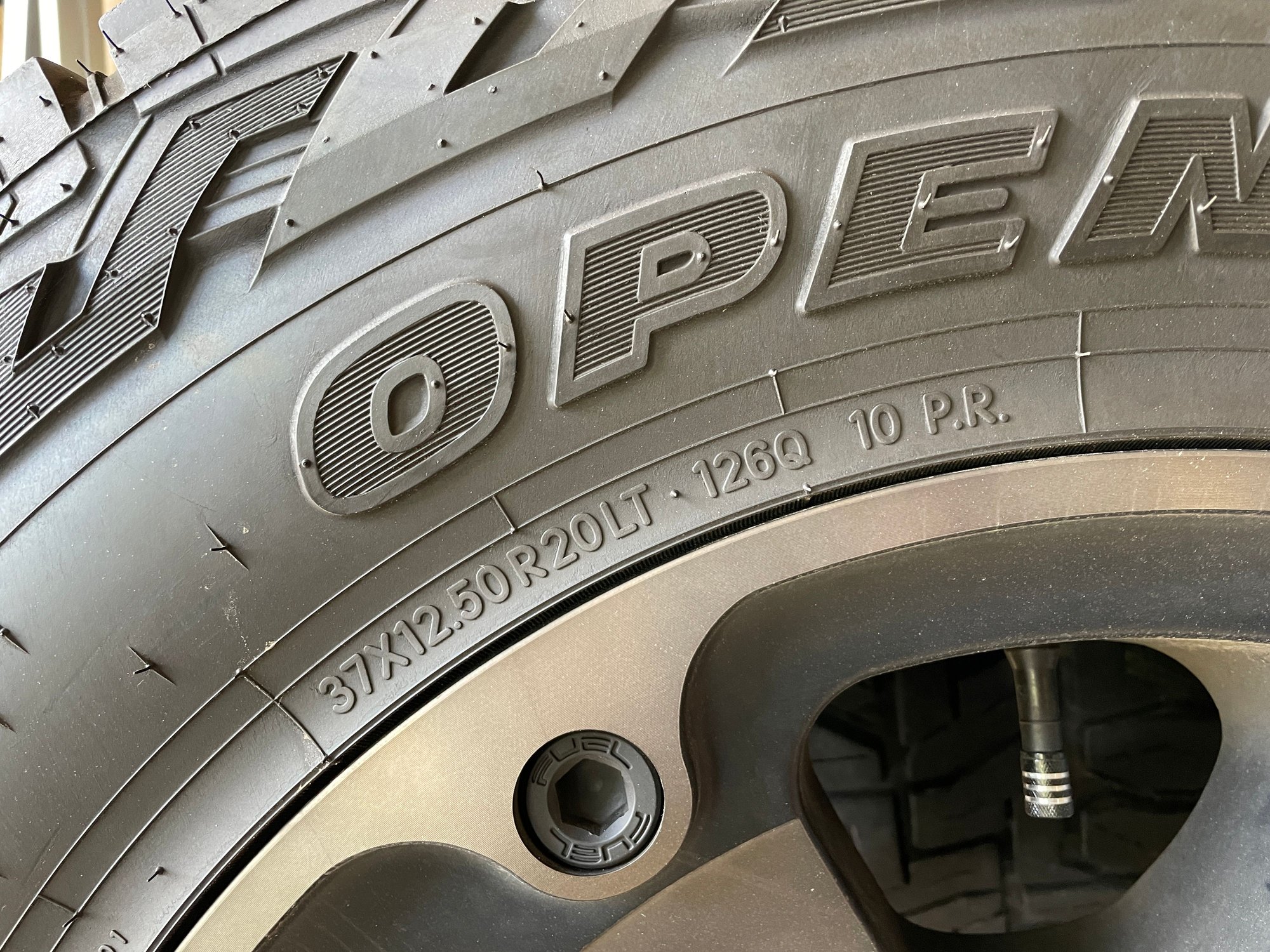

I had 37x12.5R20 Toyos on my H2, and they rubbed, after 10K miles I had to swap them out as I was always doing multi-point turns just to get it out of my garage. I felt they wallowed a bit too and I never liked the ride on the highway. Perfectly good off-road tire, as you would expect. They are too big for the H2 without a lift - they hit the plastic wheel well.

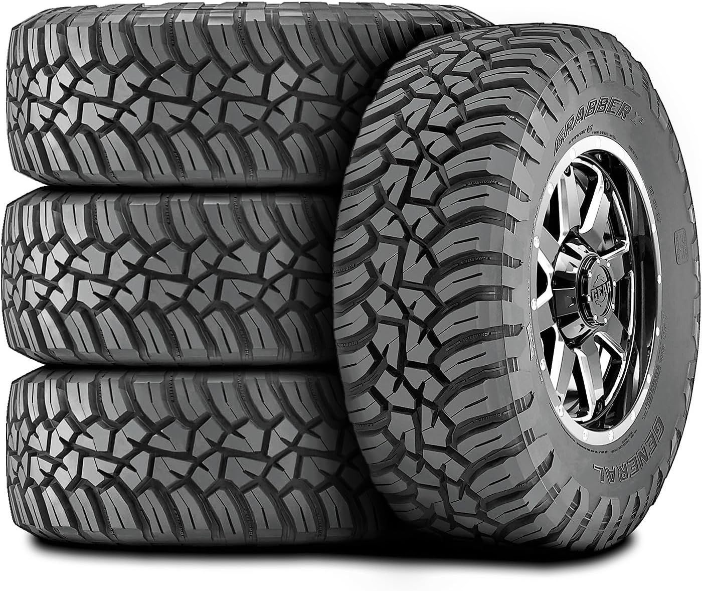

I have now had two sets of General Grabber ATX 35x12.5 and cannot be happier. Great on the highway and offroad. They do not rub.
NOTE: the 35x12.5 should not be mounted to the stock H2 wheels as they are too wide. Use TireRack or Custom Offsets to get the right wheels that fit the H2 for a 35x12.5.
Excellent choice! Load range E-10ply-65psi+increase max load!
