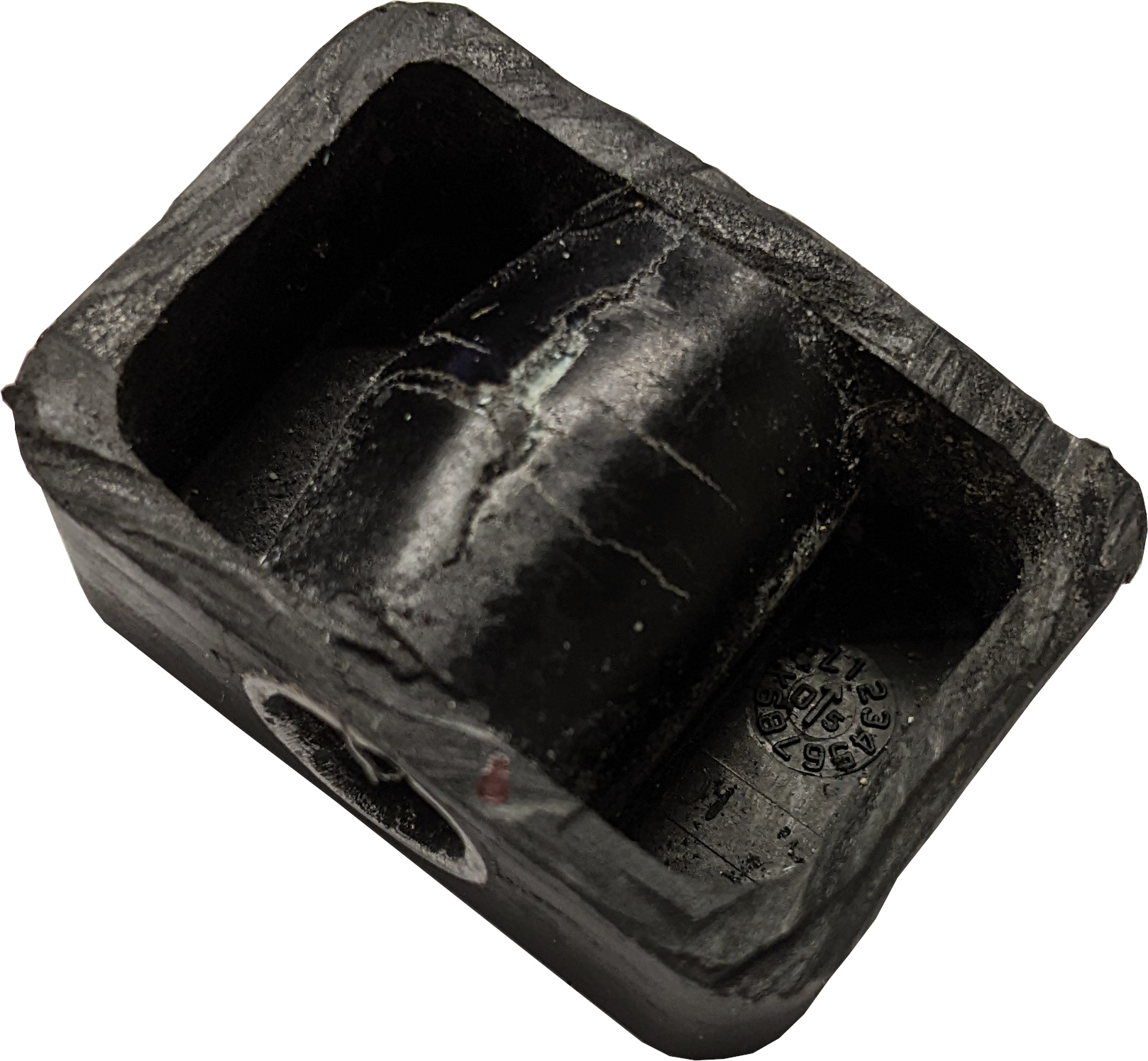

did the sensor fail the usual way? water intrusion causing it to swell and crack? the suburban's / tahoe's , truck's and Cadillac's have similar sensors i wonder if those can be interchanged / used.
i do see rock auto sells A/C kits that consist of compressor, condenser, receiver drier and seals is that what you used for replacement?
Sorry bronxteck, yes 16oz, my mistake rarely use imperial units here.
Yes as you say, the alloy metal insert in the sensor has a large cavity which filled-up with corrosion, swelled and burst open, you can clearly see the crack and faint hint of blue corrosion. In reality the sensor is up-side down, if it was bolted the other way up any condensation would pour out rather than trapping the water.
The inside had water in it and even though the PCB is coated in protective gel, it failed to stop the electronics from shorting-out. You can just see the date code was Jan 05 17 years old!

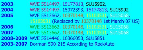

These are the sensors that I've managed to cross-ref taken from a variety of on-line sources and of course R/A. Mine was 10370848 which FedEx nearly lost.
I noticed that some YouTubers have used sensors outside of this table which seem to work, however I don't know how sophisticated the sensors are, they seem to be pretty complex devices.

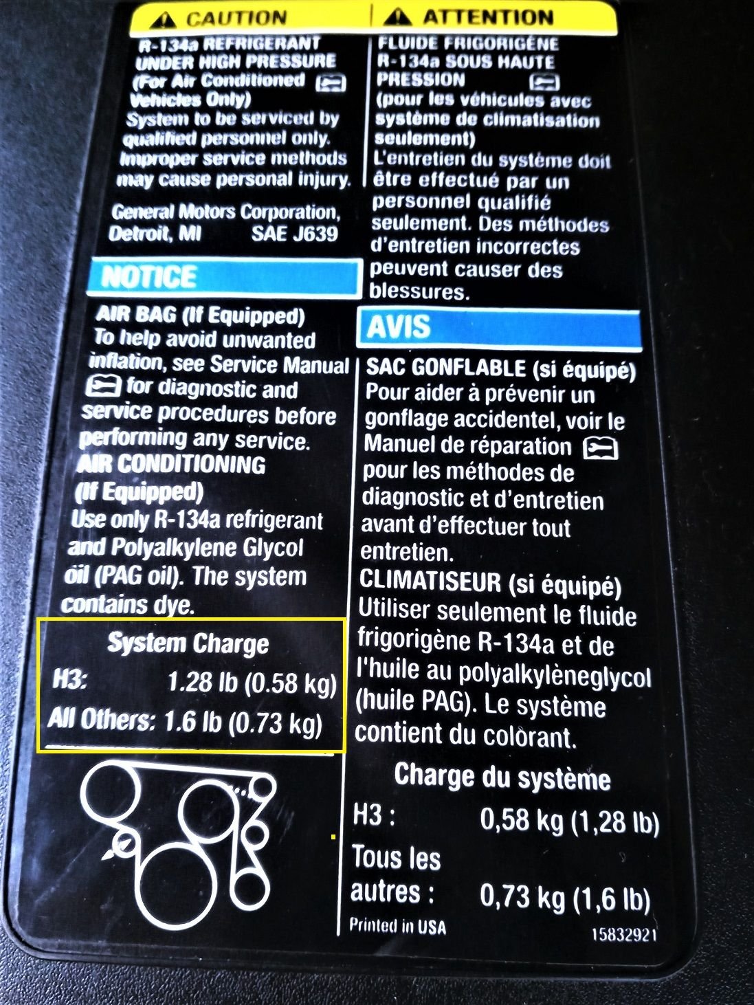

also i have a 2003 which seems to use 1.8 pounds for some reason from what i read? is that correct?
i dont know if walmart delivers to your side of the pond but seems the place to still get it at a reasonable price before the tree huggers make it unobtainable. https://www.walmart.com/ip/SuperTech...2-oz/100977940
My oem sticker(on the air filter housing shown below) shows 1.28lbs on my 3, all others 1.6lbs. My A/C components are still ALL original equipment, and still blows cold. Check pressures, if low, check for leaks.
