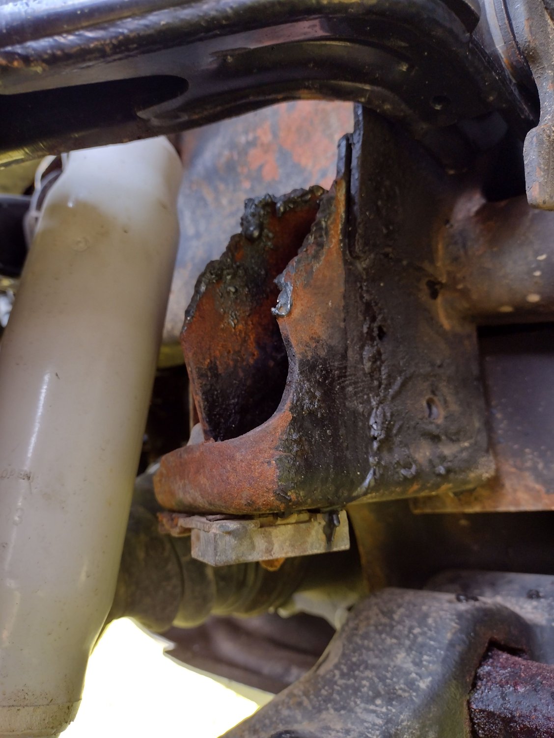

So I got my H2 lifted and the shop that I had to do it completely cut off the lower bump stops, I'm not 100% positive that that is what they're called they are not the upper bump stops they are below the upper control arm they are metal and welded on or part of the frame.
I mean who needs those right? What the heck were those GM engineers thinking, I mean of course my local Podunk hack mechanic knows way better than any engineer working for GM, I mean why else would he have completely cut them off on both sides and not even ground down the metal just leaving it all jagged, that's that good good right there I'm so glad that I got this sweet awesome good mechanic to work on my ride, he even did me a little custom job number on one side of the frame in the very back end by the rear sway bar links, I mean dude he's so good he started to cut the end of the frame that completely didn't even need it and then he quit like halfway through and just left it all jagged looking I mean if that's not pro I don't know what is! The best part about all this is he knew I didn't want anything on the frame cut, no modification of the frame whatsoever, I wanted to be able to take it all back to stock if possible, what a pal!

Ooh I do have a gravel driveway! NOICE!!! I do notice there is now a wonderful & mysterious clunk noise while turning at low speeds, I have no idea what it is but it is music to the ears! I do think that I should share some snapshots of this master-level weld-work.

the upper stops are a metal structure welded to the frame and are to limit suspension max travel for CV shaft protection,

H2-4ME-NOT-U's Avatar
Joined: Dec 2020
Posts: 53
From: Michigan
There used to be something there....
Funny thing, I specifically told them not to cut the frame...
Different angle
Other side
Yeah I know, I need to clean & paint the frame
Wtf?!?! Unnecessary!
Didn't even bother to grind it down...
Old Jul 14, 2021 | 02:11 PM
The one in your first couple of pictures are ones I was talking about that I linked above. You can see the remains of what is left of the lower stop still bolted to the bottom of the bracket. Fortunately the lower part of the bracket is still there for you to mount the LCA stops on. Your LCA's ride on those and having them might actually help. They are an important and integral part. See this thread again.... order them and put them on. https://www.hummerforums.com/forum/h...utorial-35049/

Ok, thanks! But what about the parts that were cut off, if anyone has a.moment and can take a photo of the same spot on their H2 for comparison that would be really cool. I really want to have a good reason to march back down to the shop that did this and demand a refund, I mostly angered that they cut anything when I specifically told them not to several times, that's the whole reason that we ordered the lift piece by piece.

This ^^ is 100% Correct, To Limit Max Droop travel add to that CV shaft Joint protection the upper and lower ball joints from over binding. control arm bushing over rotating (ripping). and what they did is plain ugly. What exactly did you get for a lift? looks like over cranking the torsion bars and those stops got in their way?
