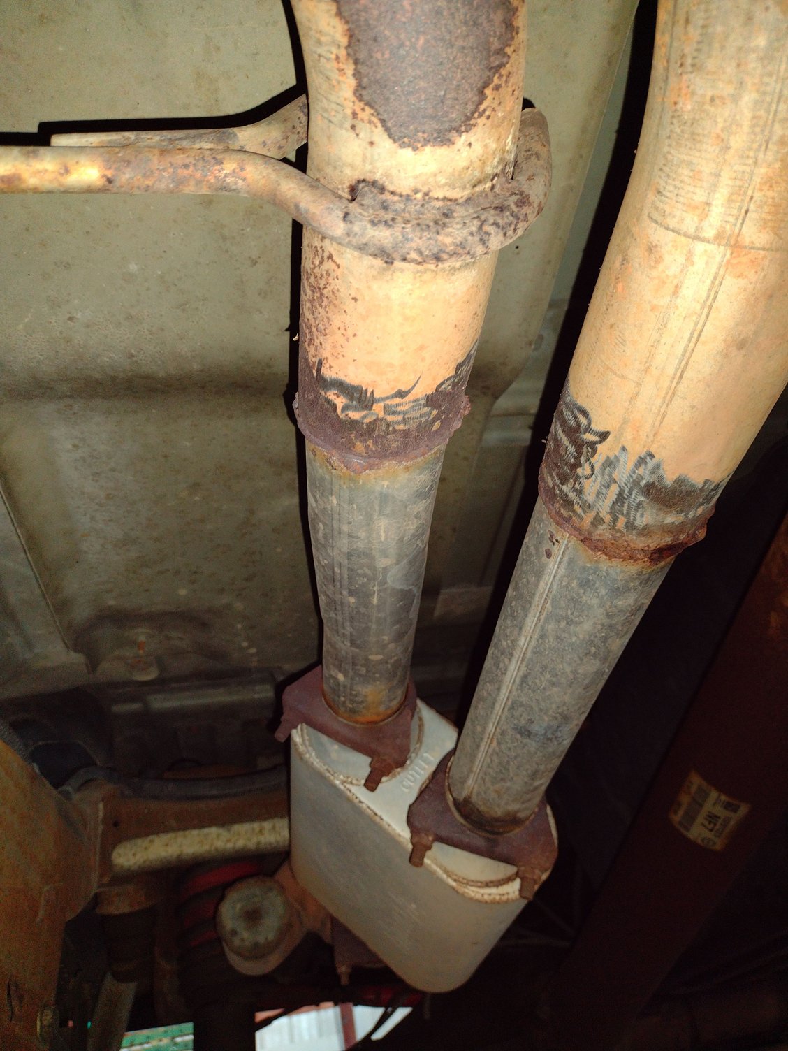

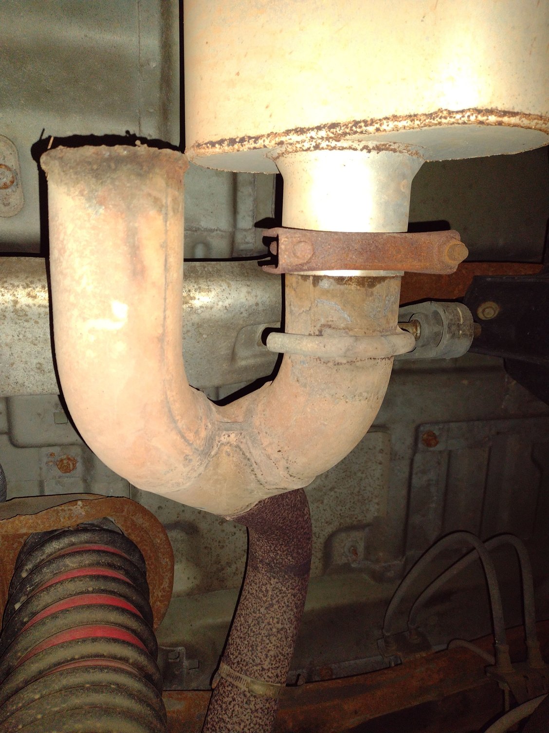

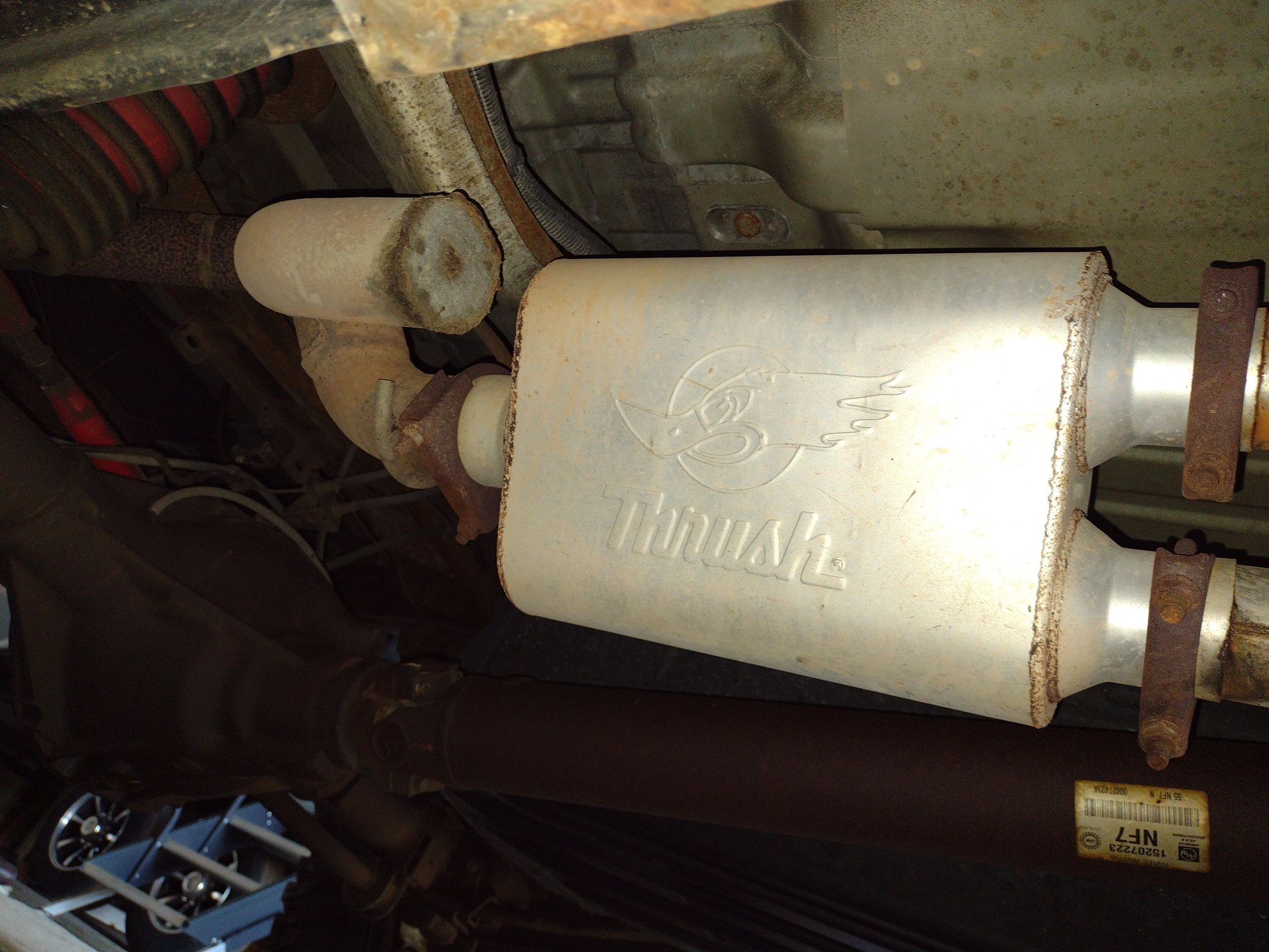

Noticed this while poking around .... handiwork of the same shop from earlier this year....

Old Jul 27, 2021 | 10:40 AM
So they replaced your two in two out muffler with a one in two out and just capped one pipe on the Y..... wtf??? That is likely causing all sorts of odd turbulence and bursts of backpressure.
