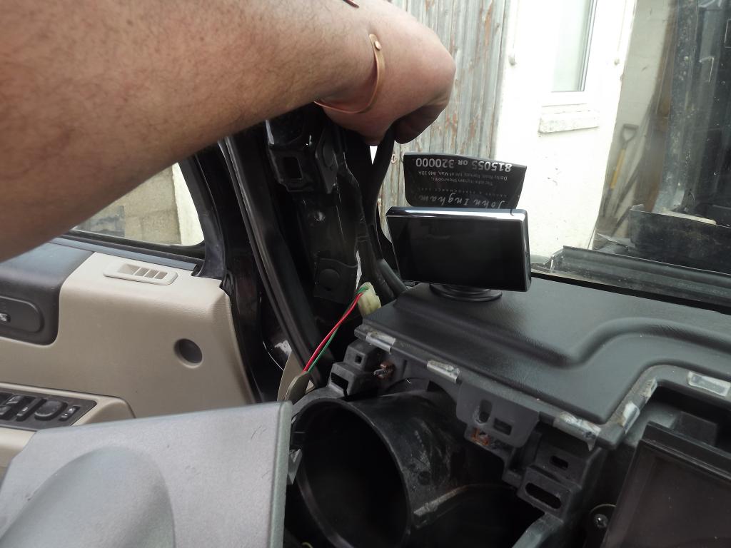

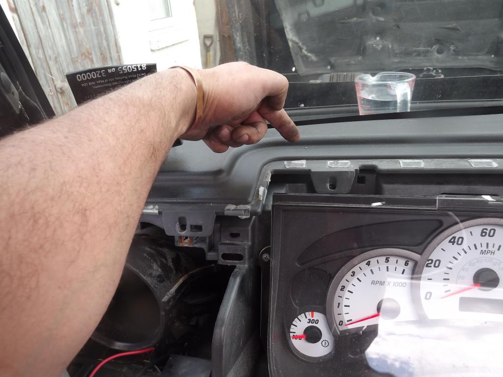

OK so today i had the chance to investigate properly , my dash is in bits and the scuttle panel in front and outside the windscreen is off . We all know the drains start in each corner of the sunroof under the glass , glass which can be removed entirely by undoing 4 bolts . It then runs down the windscreen column seen here
And disappears through the bodywork about here
And the final exit is just under here
Mines blocked solid wires won't budge the blockage and unfortunately i don't have my compressor as it was left at work .
Regardless the design is diabolical even when it works the drain is routed in such a way that it is bound to get blocked (it finishes almost in an "S" bend) though at least it doesn't have the crosspiece in the end like the H3 . Because it allows water to run freely down through the bodywork until it finds its own way out , what is that other than a rust magnet !
My intention is to remove the pipe altogether and put a new one in so it runs in a straight line down the windscreen column , behind the the panel next to the park brake and through the floor so water is clear of the truck altogether .
Hope this helps somebody else with the same problems .
