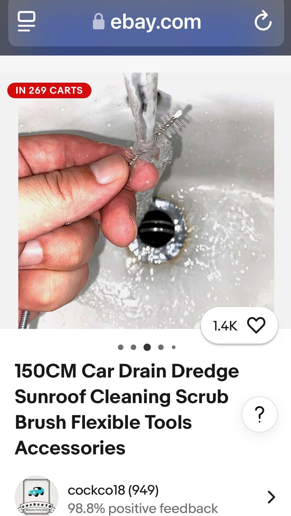

I can’t tell you for sure where the leak might be but above Hummerheads made a lot of good things to look at.
One point was made to not blow out your sunroof drain lines, if you disconnect the drains you got to demo your sunroof.
Use instead a $7 sunroof dredger to get the junk out the lines.
Yes there is something like that and I use it bi monthly on all my vehicles with a sunroof.
