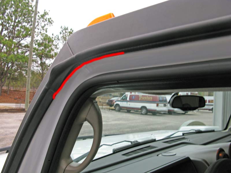

This one kicked me for a bit to finally track down.... Mine was leaking where I marked in red and that somehow makes it past the inner weatherstrip and into the inside if it is leaking behind it there.
my weather stripping is in terrible shape there on both sides but doesn’t leak inside. There is another set of seals it would have to get passed.
OP, I would recommend making sure all door seals are in good shape. Make sure they sealed the middle cab lights AND the corner cab lights. Those leak the most and they are a PAIN to get to and seal. Inspect the sunroof surround catch(that catches the water before going in the drains) for cracks.

@MixManSC can you tell me what that piece is called, i need these for sure, this is where my is soaking the floor, right in the bend, the weather strip is seprated from the pinch weld, well thats for starters, but i need this strip and dont know what the name is ,

removed mine and cleaned it very vigorously in a soapy water bucket. to remove all the dirt and slimy crap that was sitting in the pinch channel with a stiff brush and a flat tip screw driver then let it dry. i put the weather strip back on and in that area mixman shows the red line, i used a strip of 5/16" 3M VHB tape between the weatherstrip and body. NOT in the weather strip channel
