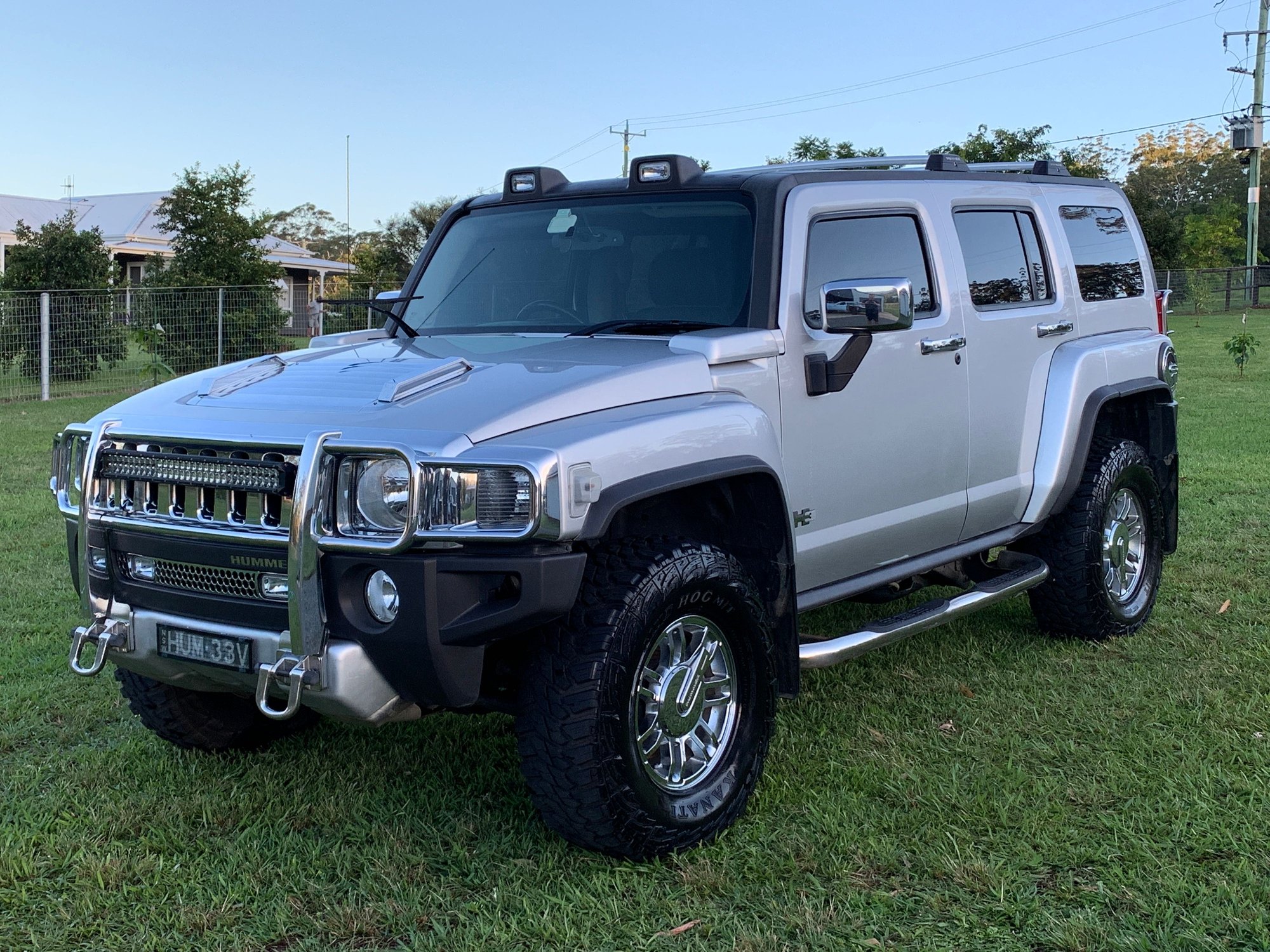

Hi,
I have a 2009 H3 Hummer that I have owned since new, it has well over 200,000km on the clock and I have recently had the automatic transmission rebuild as it died.
In the last week or two I have noticed water in the driver footwell, we had a lot of rain lately and I assumed it was just water from the rain or possibly sunroof drain tubes.
I park the car in a dry shed and I dried the carpet out, and on the week end on a nice sunny day I took her out to go fishing and the carpet was wet again when I got home, I could not see where the water comes from.
Anyone have any idea what the issue may be?? And more importantly how to fix it.
Photo of my H3 attached for interest.
