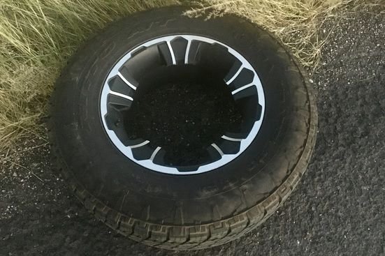

Forget the wheel spacers, not needed and tough on bearing, hubs and can cause premature failure of aftermarket cast wheels if you hit a bad pothole, or unexpected road debris etc.
Besides if you get the tires outside the wheel wheels while some may like the look they make keeping the truck clean a nightmare with road grime, mud, rocks and other stuff just getting all over your H2.
