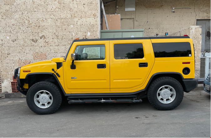

I'm done with the compressor always failing & the cost of replacement. Please suggest a kit to go with for a 2004 hummer.. if you can please list Part numbers. Thank you
Here's what I found while browsing:
-StrutMasters SUSPENSION CONVERSION/DELETE KIT WITH REAR SHOCKS (HA1RB) - would I need to replace fronts as well? is that a complete kit or are there other parts that I need to replace?
Do you recommend I go with another part?

At this point i don't want to fix the bags anymore and have them fail again later. The ride is disastrous right now and need to replace asap so I wanna go with the conversion.
I'll replace the fronts as well with whatever rears im getting. Could you please suggest what best options to go with (OEM height) no lifts/drops...
Arnott
Strutmasters -
what else.. thank you
