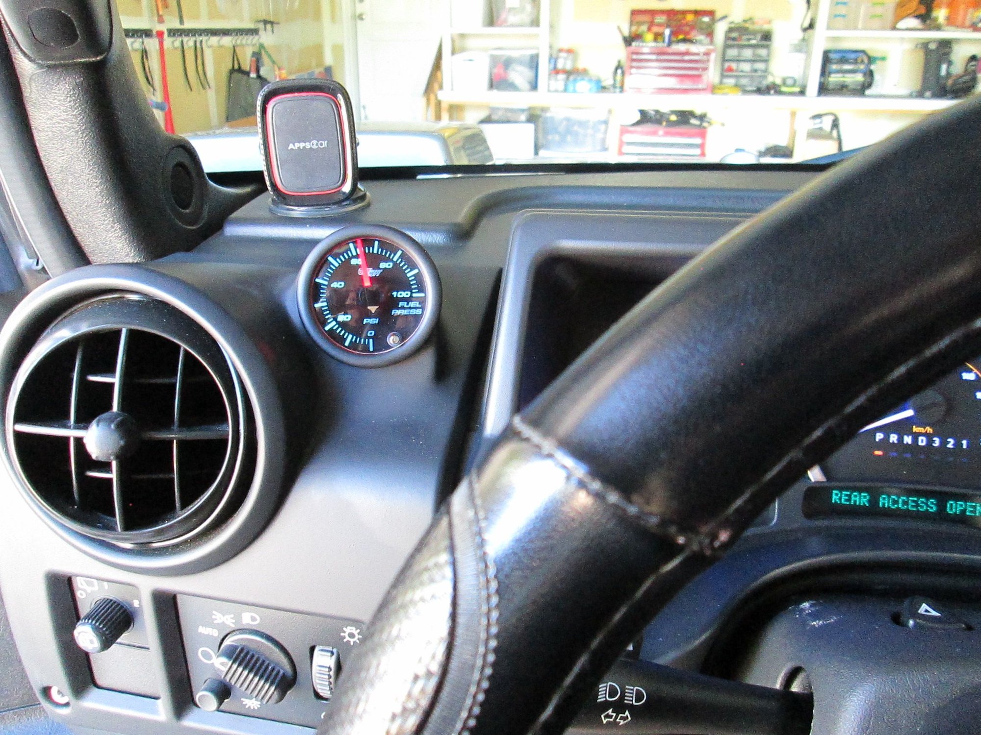

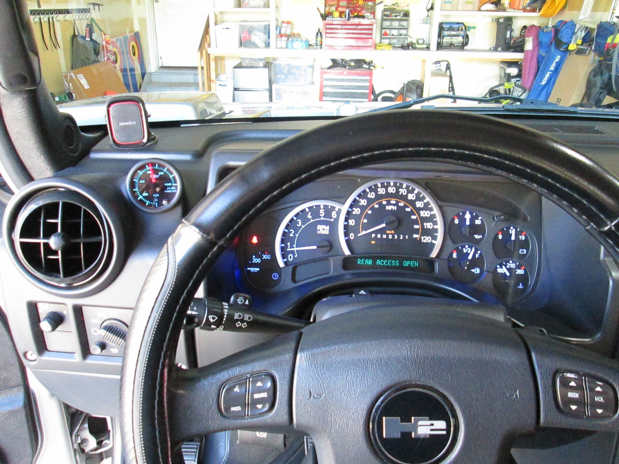

This was a pretty easy add on. Always thought a Fuel Pressure Gauge was a necessity.

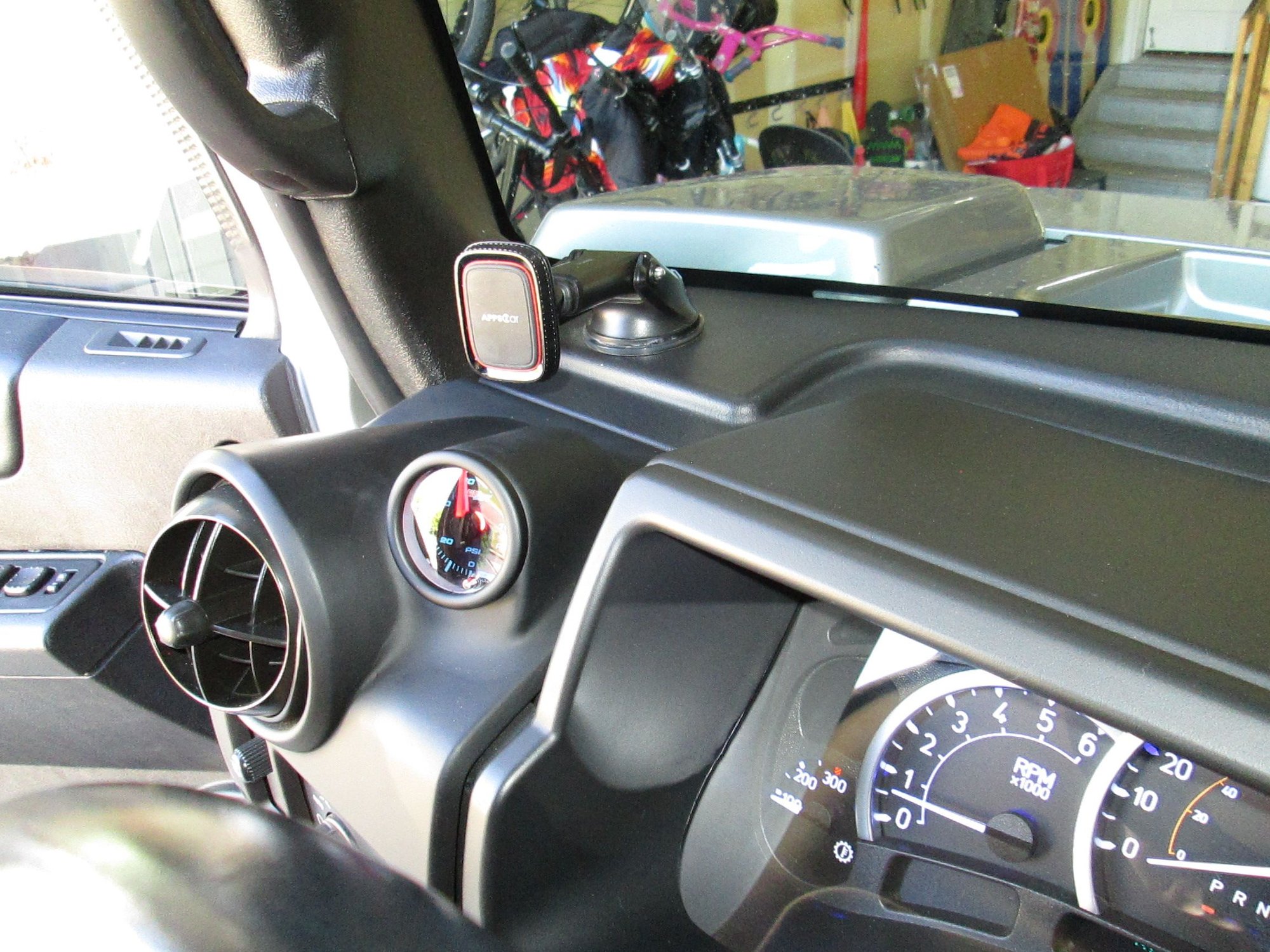

Had to carefully position and slowly trim the gauge pod to the perfect angle, so its very visible when driving. Bonded it on with a plastic cement and then cut out the innards and so the gauge would seat all the way in. Molded in some bondo and sanded it all smooth, then finished with the Rust-oleum Chalkboard paint.
Glow Shift gauge and fuel rail adapter.

Fantastic installation. Where does it pick up the fuel pressure reading from?

There's a Schrader valve on the passenger side of the fuel rail.
