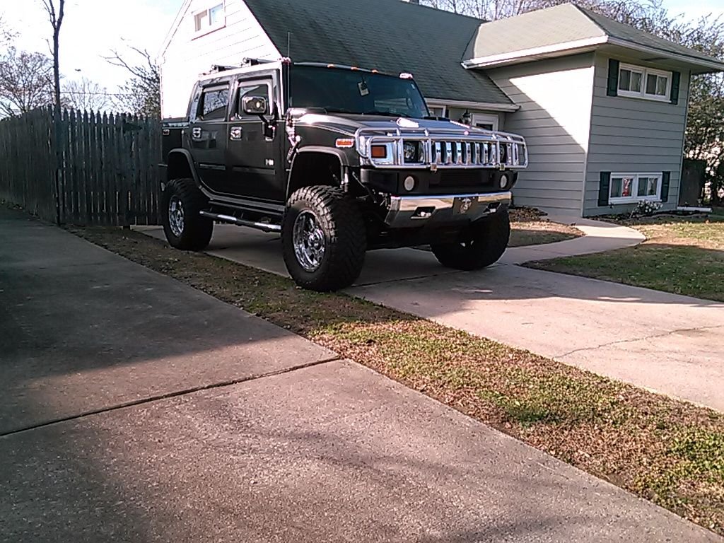

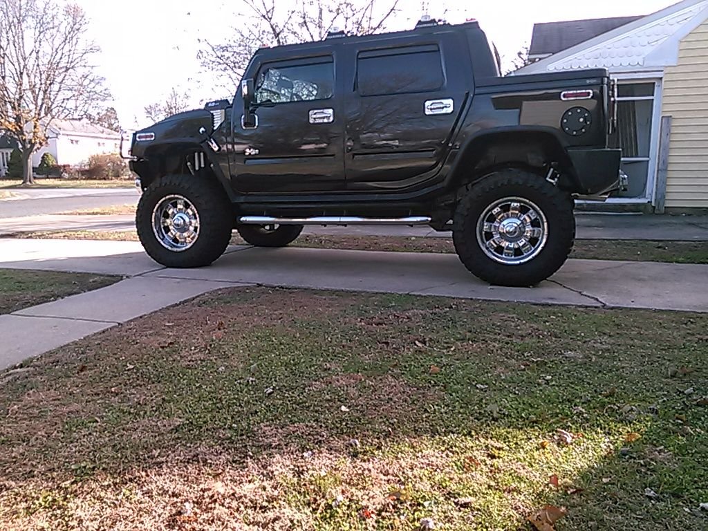

I'm not sure what the offset of the wheels I had on my first H2, but I was running 38 x 13.50 R20's on mind.
