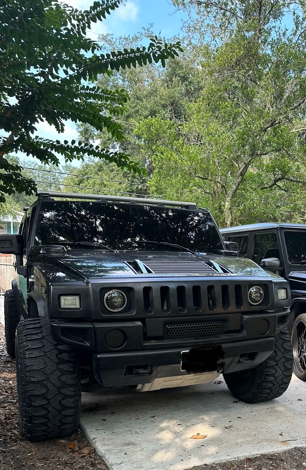

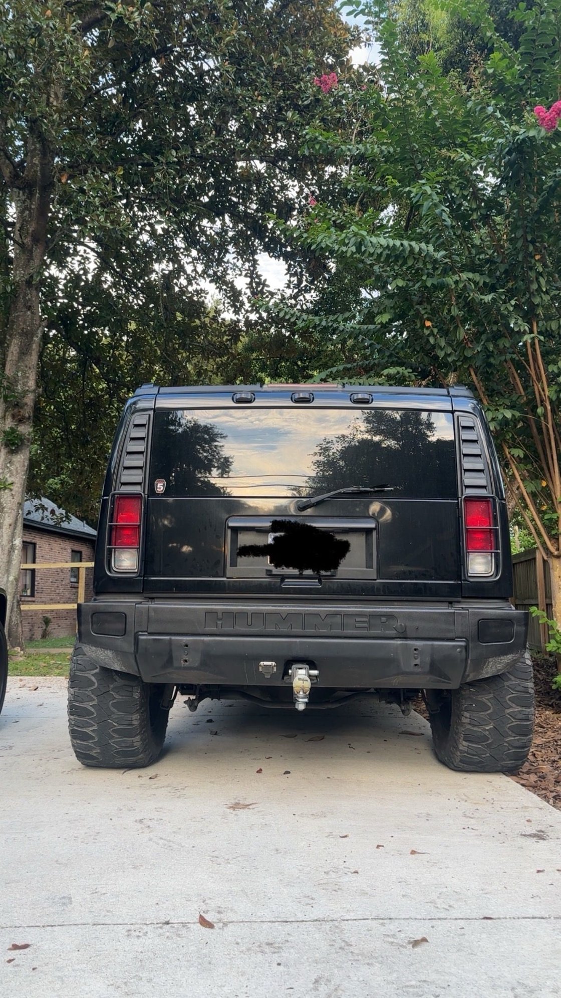

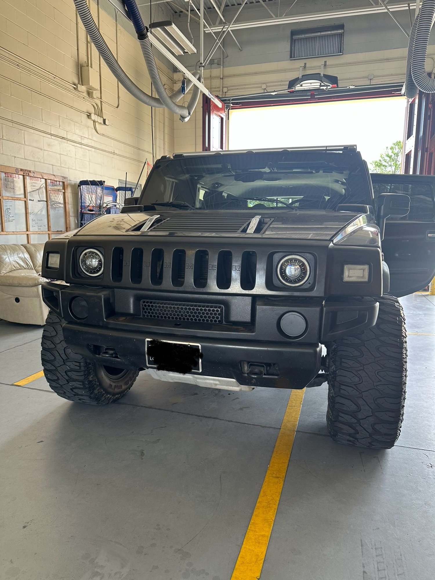

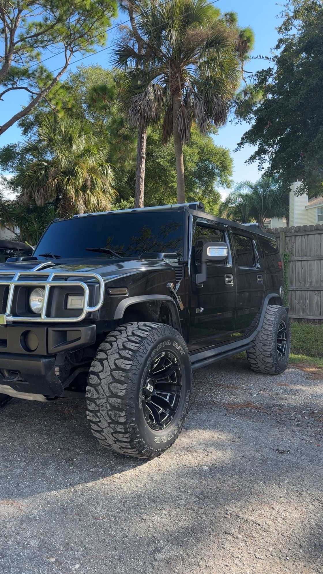

So found a deal on marketplace for some 38x15.50R20 with a super negative offset and picked them up! Was pretty stoked that most of the rubbing was on fiberglass. Cut out everything around the firewall trimmed the fenders and slid the flare back. Looks factory!! Hard to tell in picks but changed the whole truck. Low and wide love the look! Down side is it robbed what little power the truck had lol. Have pulled and built diffs in a few older Toyotas. But can’t really find any walk thru or vids on doing a gear swap in an H2. Will be towing a boat so thinking some gear range around a 5.10. If some could help lead me in the direction on what axel is factory in this 05, is there a factory locker I need to be worried about? Also annyone sell a rear differential with 5.10 gears already in it?Any info on someone doing this would really appreciate it! Just doing the rear for now. It’s my daily so hopefully can do the rear in a weekend then do the front the following. Understand not to use 4x4 until it’s the same ratio
