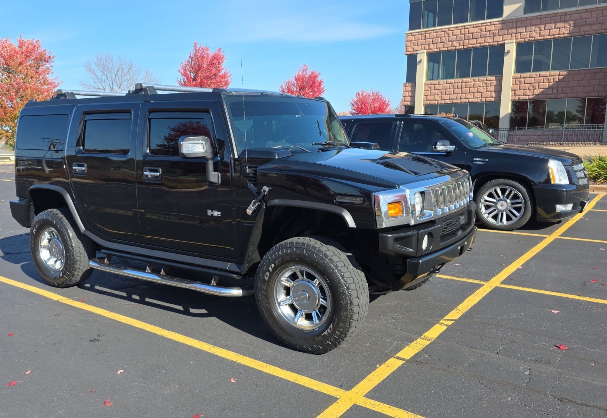

Hello All. purchased a pretty clean 2006 H2 Luxury a couple months ago. fixing little quirks and trying to do some research on a random noise.
The clunk is a vehicle shaking clunk,seems to come from front lower end, right when the engine is turning over and starts. Almost always when it sits overnight. Not too often after a recent drive. I have noticed the brake pedal jumping up to "high and hard" firm pedal but not as experienced with hydro boost if this is normal. Before I got ripping and tearing I figured I'd see if anyone else had some input or similar problem?
