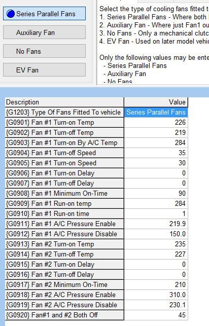

Yep - will need to be EFI Live or HP Tuners (or some other custom tuning solution). I'm not aware of any handheld tuner that can enable them as there is a good number of parameters that need to be entered after enabling them. I have EFI Live - this is what some of the options are....
Another couple of bits of info that will be needed will be to determine what the correct AC head pressures should be on our H2's. I'd prob just cross reference to verify that the trucks use the same compressor and if so go with the stock truck numbers to start. This is what EFI Live showed for a stock tune for an 05 Tahoe, LQ9 6.0. Probably close but I've seen other tunes show much different pressure values....

i went the lazy root with the Be Cool version paired with Flex a Lite 294 fan and changed the alternator to Mechman b8206370b elite 370-amp with big 3 to cope with the 6000-cfm fans
