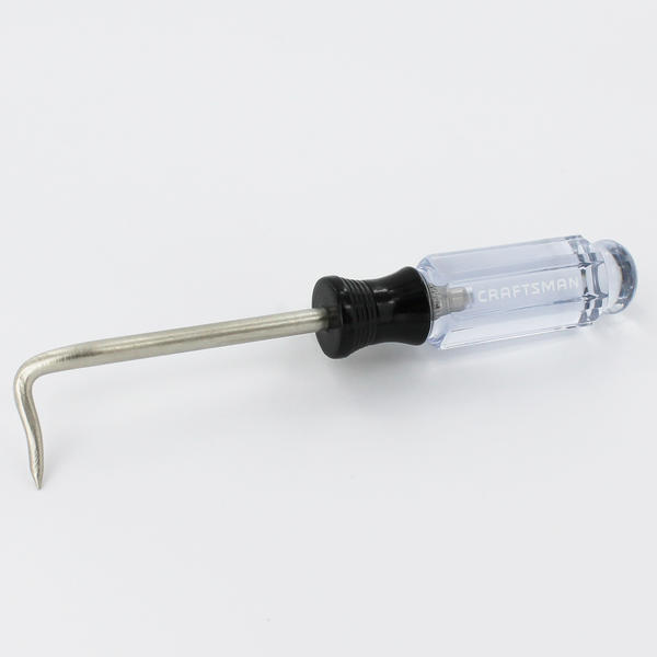

If you run into that situation again take a coat hanger bend a tight loop in it. Bend it to hook over the far part of the clamp and pull it towards you, the clamp will rotate to where you can get it with the pliers.
you are actually pulling on the clamp as if it was squeezing the clamp open which helps it rotate.
Done this many time with various vehicles.

The trusty old Craftsman Cotter Key Extractor works great for that stuff.
Doc,
I have an old screwdriver I bent like that...........Now I have a name for it!
