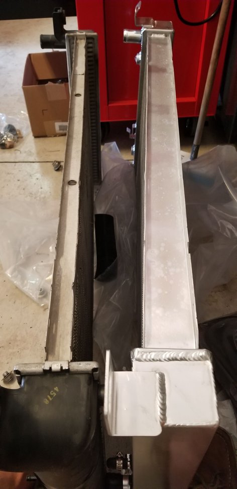

Work in progress.....
I also had to r/r power steering pump as the old one was not keeping up with my new Red Head steering box, turns out one of the return hard lines was slightly crimped.
Radiator was pretty easy, slight fitment issues but no big deal.. The new one is an aluminum 3 core unit. Threw in a 160 degree thermostat too. I'll kick fans on at about 180 and see how it runs. It used to run in the 200-205 range prior to this and transmisison would run about 180 to 190.
Fans tomorrow I hope.
Old single row
New 3 row
Huge difference!

Champion makes them and they are sold under several companies. I had issues with their vendor so went to Amazon. I'll see if the box has a manufacturer name on it but I don't think it did. It was $217 and is extremely well built and included all the fitting and hard line clips. The Champion units were about the same price. I see no need to go to Be Cool or Griffins ate 3 x the price.
The key is to make sure you get a 34" core, not the smaller version. It was a direct fit with only very minor trimming needed. I think they are the same for Silverado's, Escalades, etc....
One word of warning to everyone....DO NOT, repeat DO NOT try to remove the quick connect fittings from the plastic ends of the factory radiator. The oil and trans-cooler inside will drop and you will never, ever get it attached again and then there is no way to seal the radiator. I tore mine apart just to see why they fail. Imagine a small metal/aluminum radiator looking apparatus inside the plastic end caps. They would have had to have been connected at the factory prior to the plasatic end caps being installed to the radiator core.
