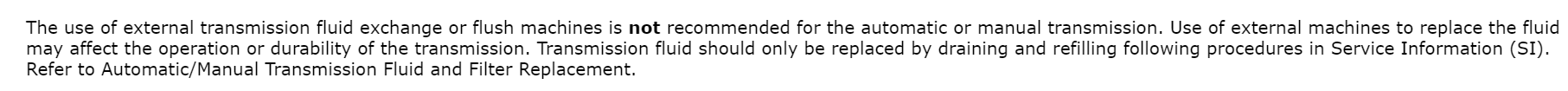

Took my H2 to the dealer for a new Radiator install. While there since they had to break the tranny cooling lines lose and the oil cooler lines lose I figured I'd have them do a tranny service and flush and refill With New Tranny Fluid. There's 72 K on the clock and it was serviced @ 50 K. So I was told by the Mechanic that day that GM does not recommend changing the filter out anymore. So I said ok.
So I have a Bud That works for GM and he's in the know with Service and Warranty Authorization and has access to GM Service Bulletins. He called BS on the not changing filter and sent me the procedure in "PDF" format. There is a new seal that comes with the filter that is inside the upper body of the tranny that has to be removed and the new seal installed which requires two special tools Some guys just use a socket to drive the seal in. Anyway..the trick is getting the old one out.
At 50K they did not change the filter either...they just flush the system with new fluid. Looked at my old receipt. My Bud said that most dealer techs don't want to drop the tranny pan because the exhaust is in the way and the PDF calls for disconnecting the Catalytic Converter as it's in the way. Youtube shows a guy removing the heat shields bolted to each side of the tranny and prying a bracket out of the way to pop the pan. He also never changed out the seal that the tube pushes into.
So Now My fluid is perfectly clean and clear so I'll wait to 100K to have the filter changed. Problem is... I don't trust the dealers anymore and you can forget about any of those chain Tranny shops. Now I have to find a Place I can trust.
So What's your Experience with having your filter and seal changed out?

I do it myself, I do think that a flush prior to a filter change is a good idea.
If I didn't do it myself I would find a local trans shop that people trust and get them to do it.
What is the world coming to when you cannot convince the dealer to do what you want?
Its easier for them to connect it to a machine and flush instead of pulling the pan but still charge the same money.

Properly performed transmission flush, doesn't completely clean the filter & pan. Drop/clean the pan & replace the filter for longevity!

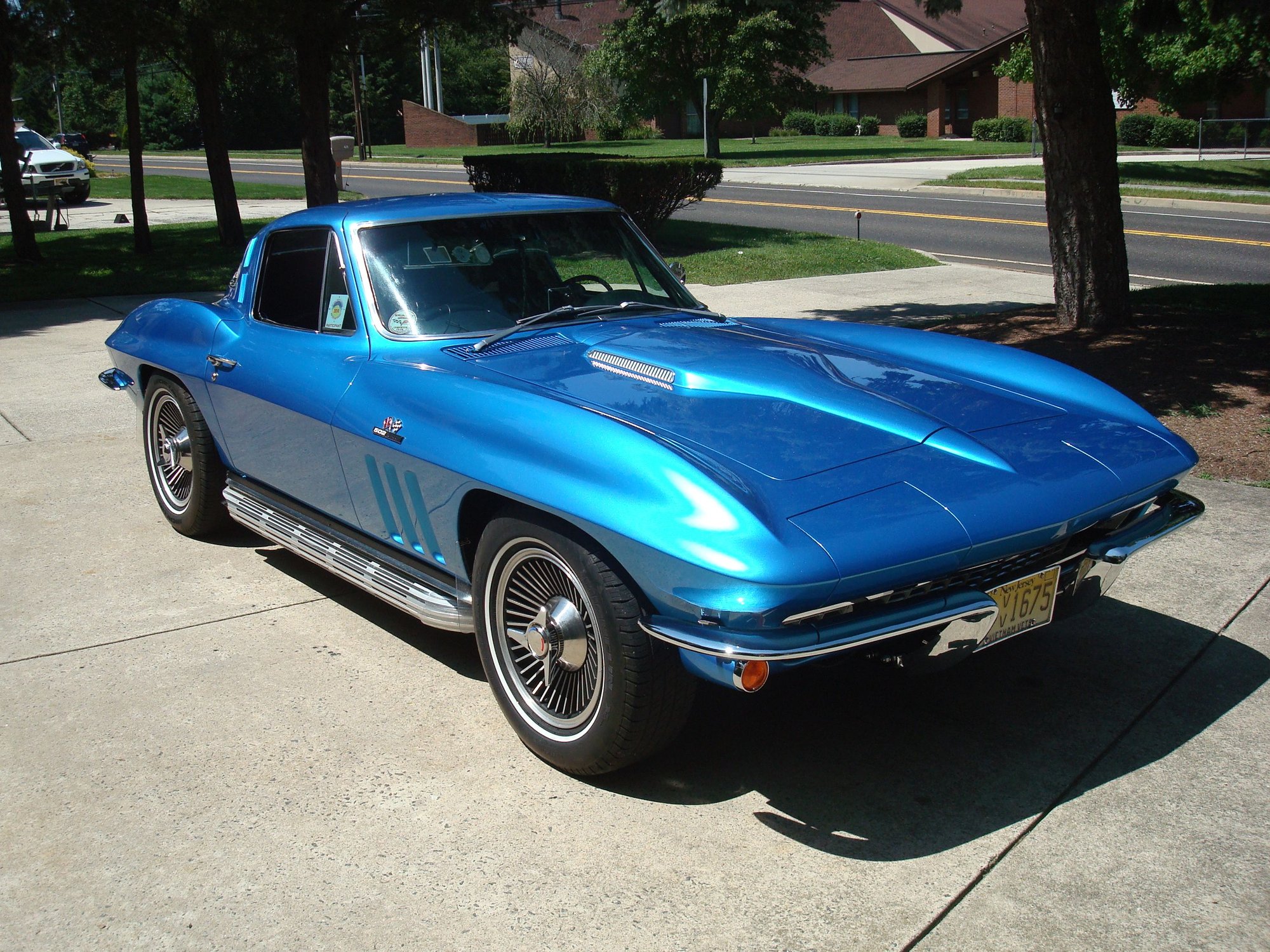

Thanks for the reply. Yeah ...if I had a Lift I'd do it myself. Like you I don't trust these guys or any tranny shop. I do all my own work on my 65 Vette with a 502 BB. I been wrenching for years. I was with the Combat Engineers in Vietnam and worked on Heavy Equipment of all kinds. Did my Frame off resto on my Vette so I'm familiar with wrenching. Never did a Service on an Auto tranny though. Yah gotta have a lift. I only have a one car garage and the H2 lives out side. I also have detached garage next to the house but the H2 won't fit...L.O.L.
