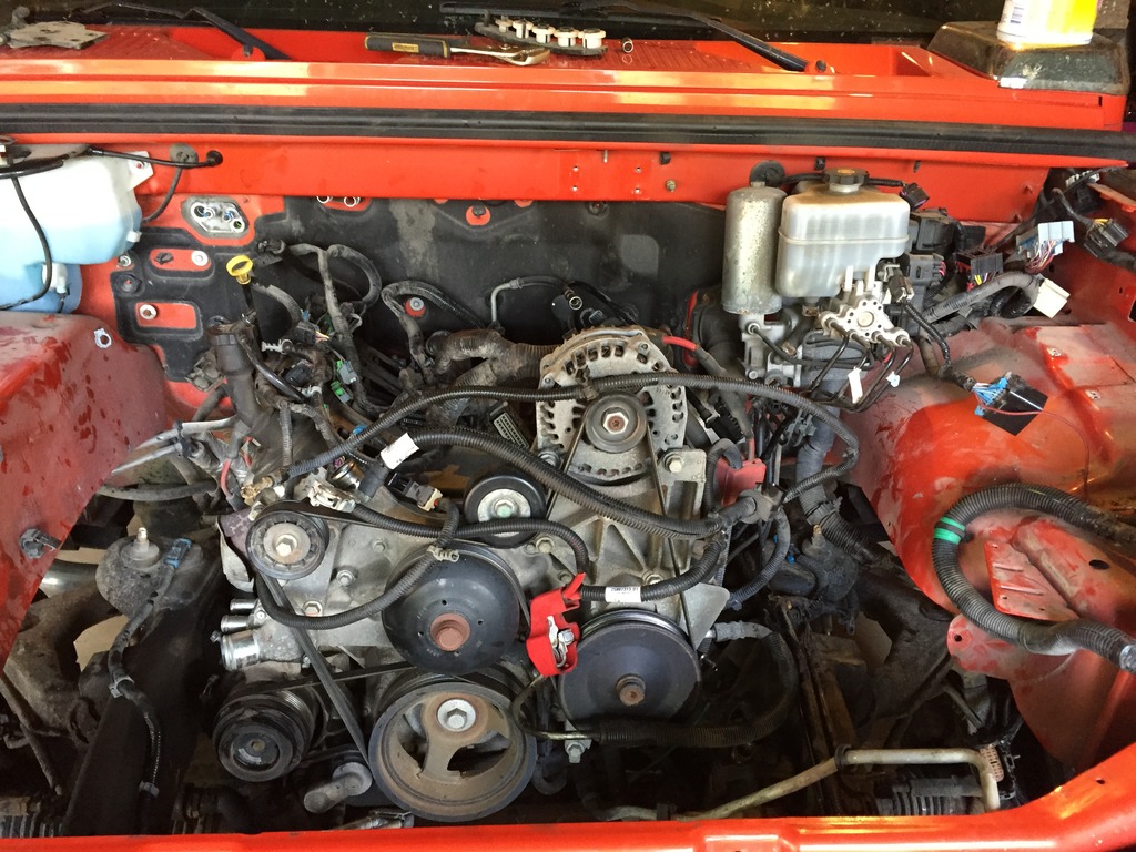

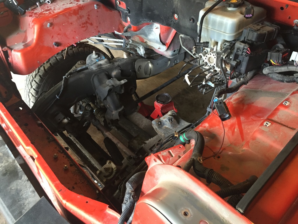

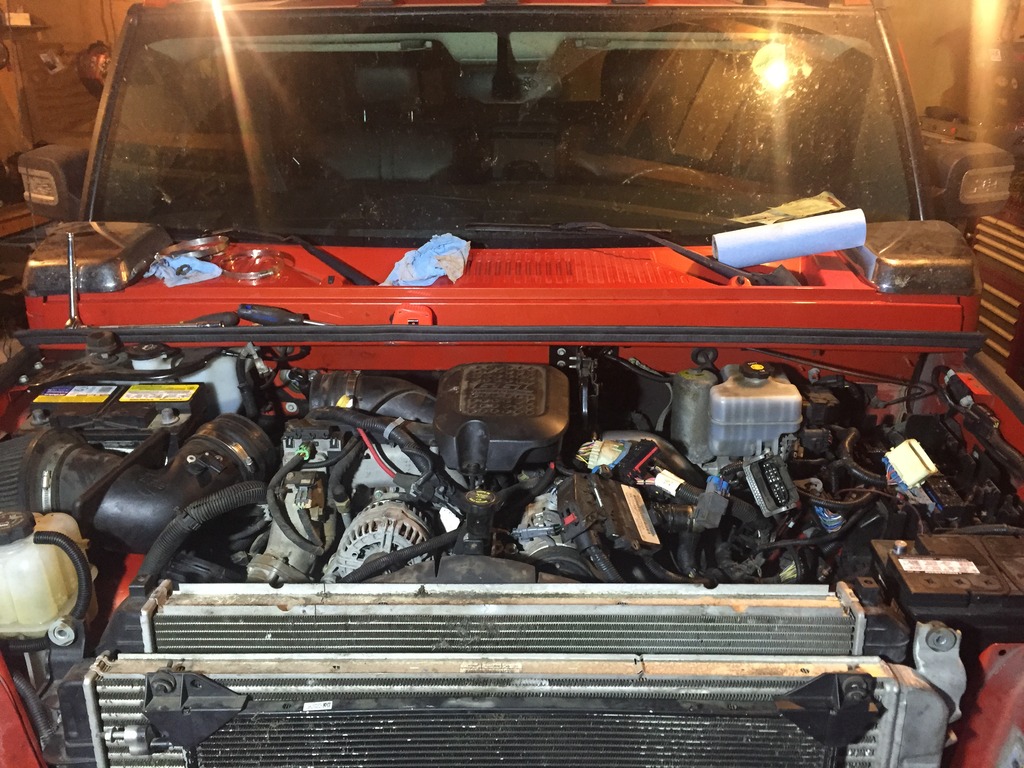

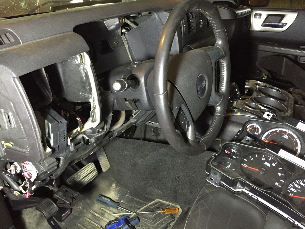

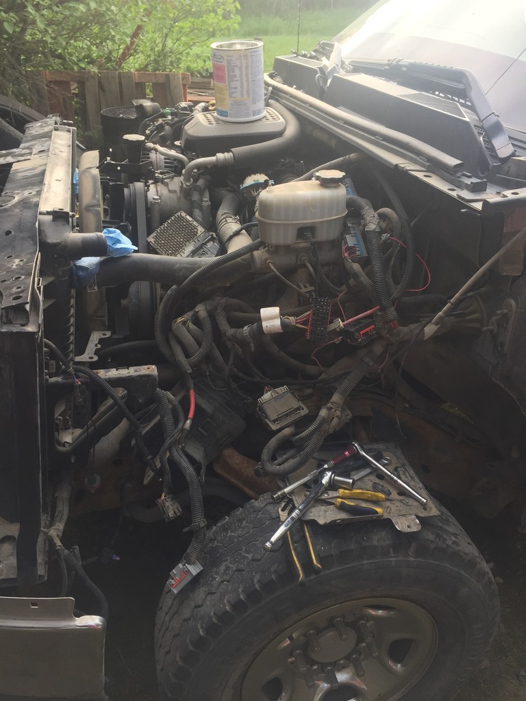

Sorry I took so long to reply, work has kept me busy! Yes, I did the conversion myself a little over a year ago and have since put on about 8.000 trouble free miles. I have no lights or error messages, everything is 100% factory, nothing is spliced and no short cuts were taken. I called up the 3 major conversion companies Predator, Mash Motors and H-Line. They all quoted me about the same $27.000-$34.000 without the performance upgrades which are about another $15.000 on top of that, they also get to keep my 6.2 and 6L80e. There is no way I could ever justify spending that much money on an engine conversion. So, to answer the question as to how much I've spend on my conversion, the answer is $0!
I got a great deal on a fully loaded 2008 Sierra 2500 that was rear ended and had frame damage, which is perfect as everything I needed was upfront and the rest I parted out to regain my money back. I paid $5000 for the truck and got back $5000 after selling all the spare parts I didn't need anymore. I ended up selling my stock engine, transmission etc for about $2500 which covered all the extra costs like my driveshafts, body lift etc. This is all based on a complete stock conversion, no upgrades and no labour costs. It took me about 400 hours from beginning to end.
As far as the actual work goes it's actually pretty simple! Engine mounts are the exact same and I simply used the Duramax mounts and screws. I took the stock transmission mount and switched it up side down and drilled new holes. Rear driveshaft had to be lengthened and front had to be shortened. I had to custom cut and bend a radiator/intercooler support upfront. Wiring was what took the longest especially to make the 2/4 wheel drive system work 100%.

I got lots and lots of pictures and info, let me know if you guys want more or have more questions.

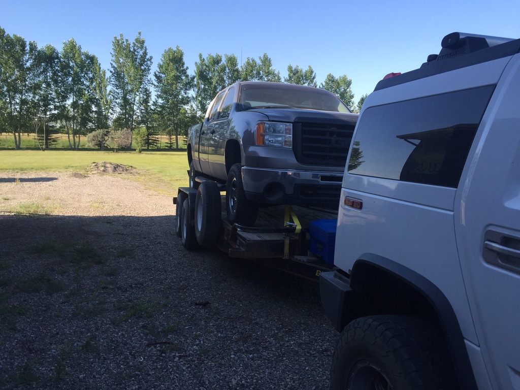

Donor truck!

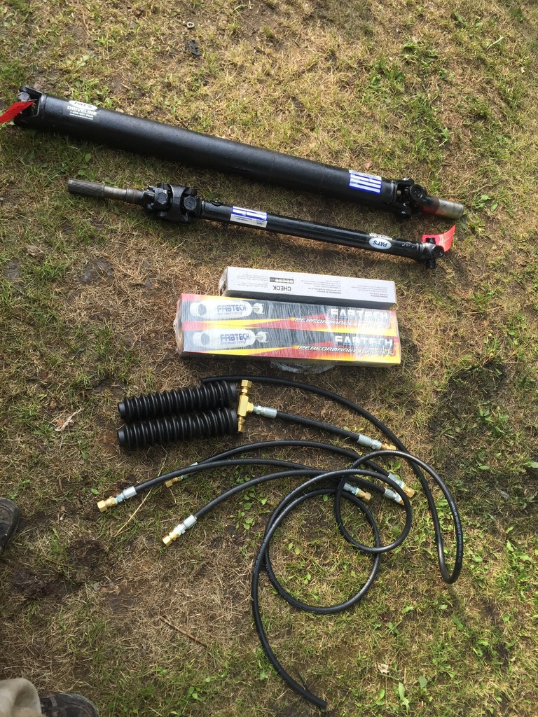

@flyday58 You can do 99% of the work just on your own besides like you mentioned the hood and a couple of other situations where you need a second pair of hands. It's got the Duramax harness and it's almost all plug in besides a few pins. What I did is I printed out the diagrams from both engines and I compared and switched the pins around accordingly. These are my stock driveshaft that I had shortened,lengthened and balanced both were about $600 to get done.

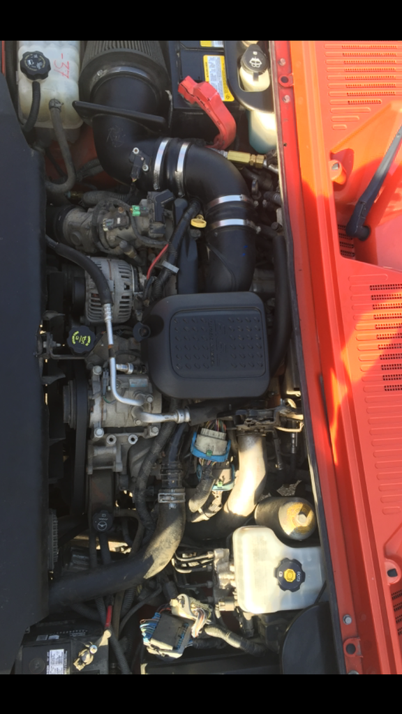

@Synthetickiller It's got between 600-750 Horse and around 1200 Torque. Going 68 mph I'm sitting right around 1280 rpm. I've never had a downshift as of right down, driving against heavy wind, 6% incline and even towing a trailer.
@madmayo No need to remove the body if you don't want although it makes it a lot easier to work on it. Both the 6.0/6.2 and Duramax can go in and out from the front. Double garage will work just fine.
