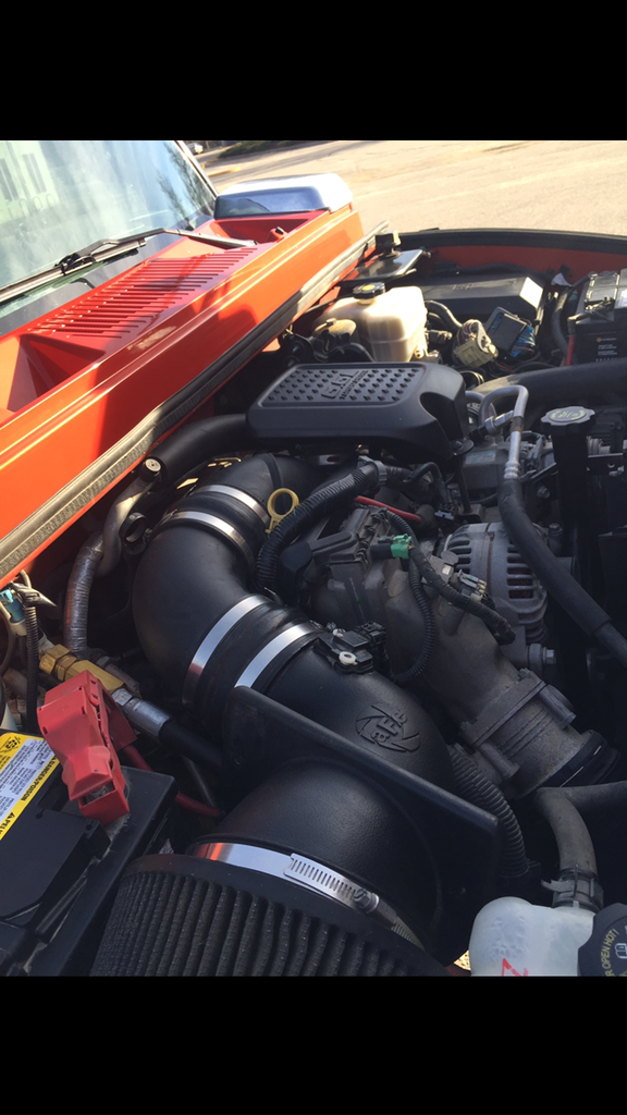

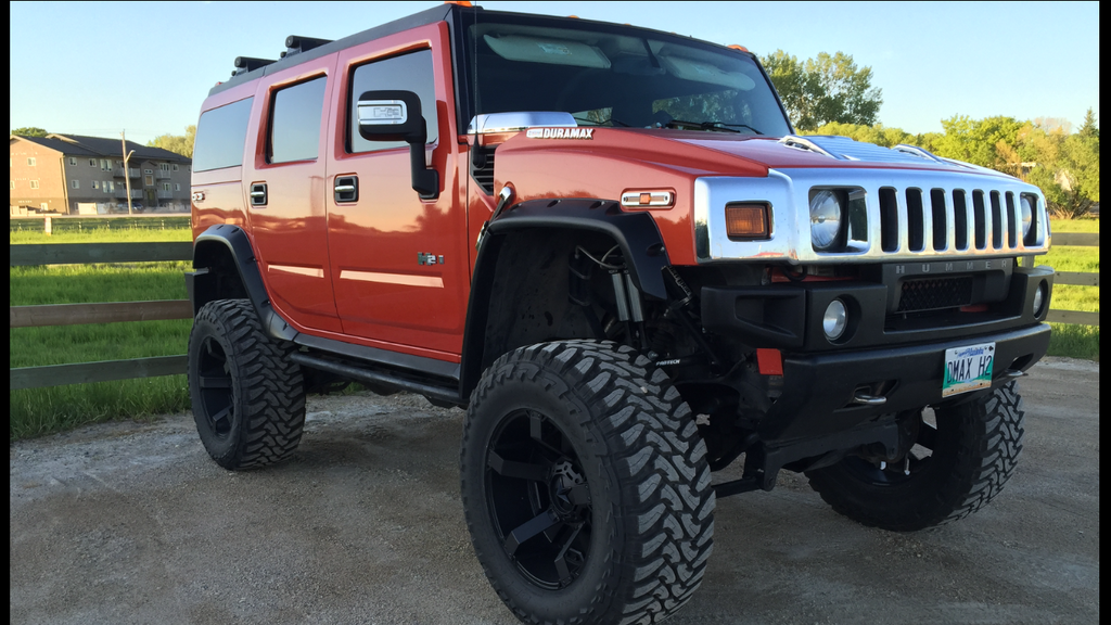

Thought I'd share my Hummer H2 Build. It's a 2008 with a full 2500HD powertrain, LMM Duramax engine with the Allision 1000 and NPHD Transfer Case with full 2 wheel and 4 wheel drive. Some of my Engine and Transmission upgrades are: 60% over injectors, AFE cold air intake, EFI Live, MBRP 5" straight pipe, Triple Disc torque converter, billet input and output shafts and Valve Body! Exterior upgrades: 6" Fabtech lift, dual front shock hoop with Dirt Logic shocks, 1" body lift, Duck head keys, 3" coil spacers, 40x15.5 Toyo's, 22x12 Rockstars 2 and E&G Fender flares. With the Fabtech lift, keys, spacers and body lift it's got about 10" of lift.

I'm curious about the hp/torque numbers it puts out.
From the pics, the engine compartment looks clean.
How's the acceleration w/ the 40" tires?
You gotta give us more info.
