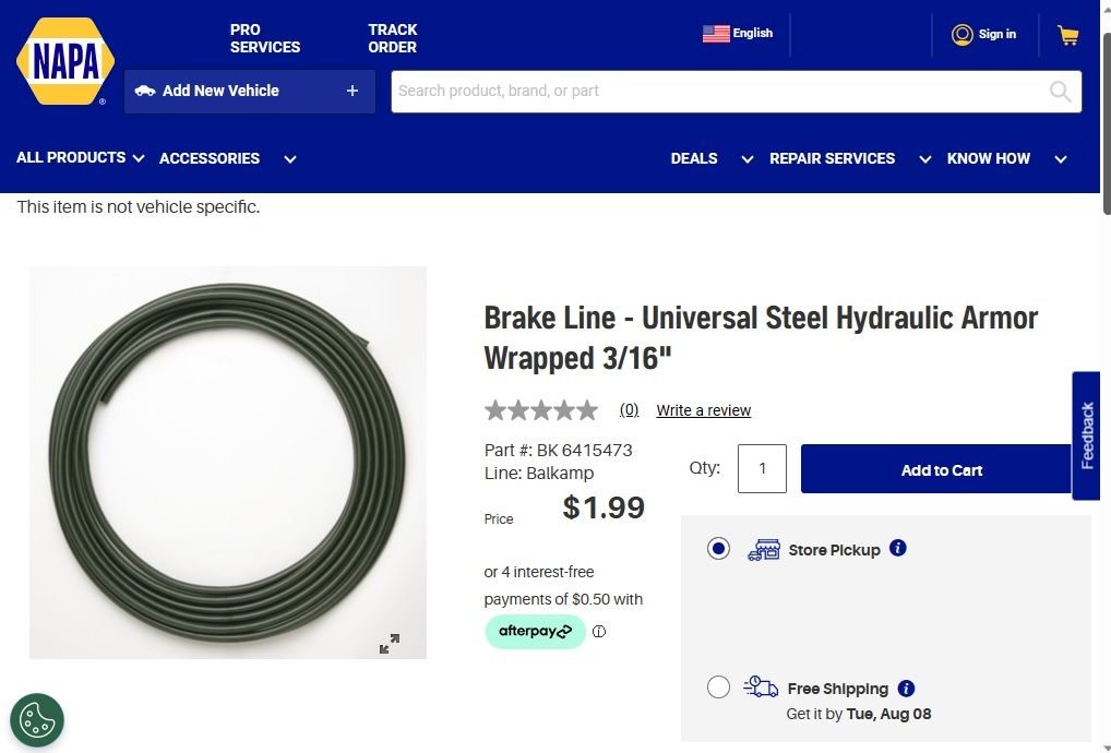

All my techs would only use the armor wrapped line after I introduced it to them. I had some techs that could replace front to rear brake lines in under an hour using a hydraulic flaring tool kit. I actually replaced all the brake lines on a '99 regal in my backyard with the armor wrap. Easy to rout in tight spaces & bend without kinking, then add/flare the fitting at both ends. Main thing is to make the front to rear lines 1 piece, that would require unions for the straight brake lines, which I've seen many leak in the past. Best to have all lines in 1 piece with a fitting at both ends!
BTW, I ordered 2 rolls of the NAPA armor wrapped last night shown above @$1.99 each
,and received an email this am:
We have an update on order #28725227
Thank you for shopping with NAPA. We are sorry to inform you that the items below have been canceled. An automatic refund has been issued to your original payment method. Please allow 2-5 business days for the refund to process completely.
