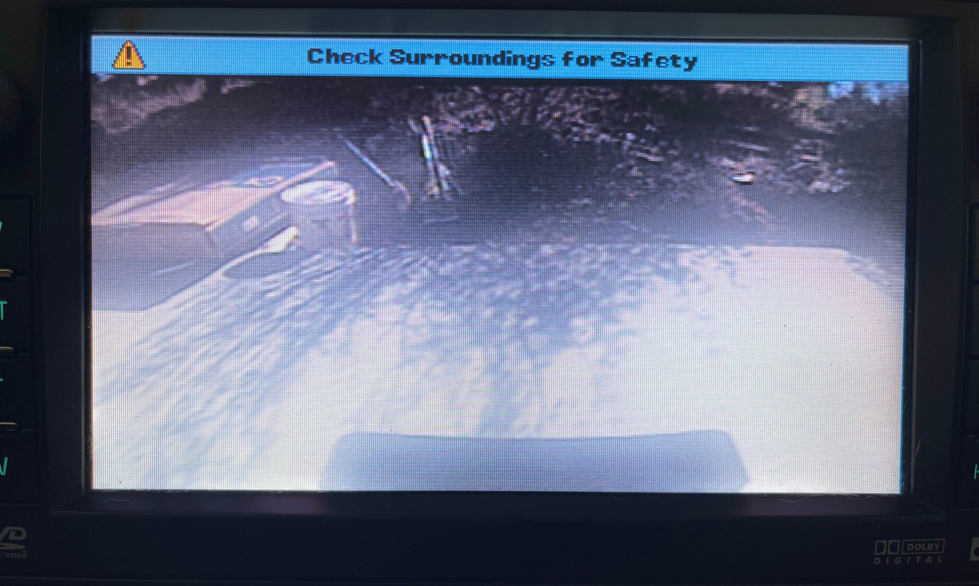

Default 08 H2 Backup Camera is Cloudy / Hazy
See picture. Does this need replacement or are there settings I can adjust to clear-up the video?

I've replaced 3 back up cameras on the back of my work truck, granted, they were all cheaper fleabay cameras, but all 3 ended up getting cloudy like your and it was from moisture getting between the lenses. You're probably going to end up replacing it.

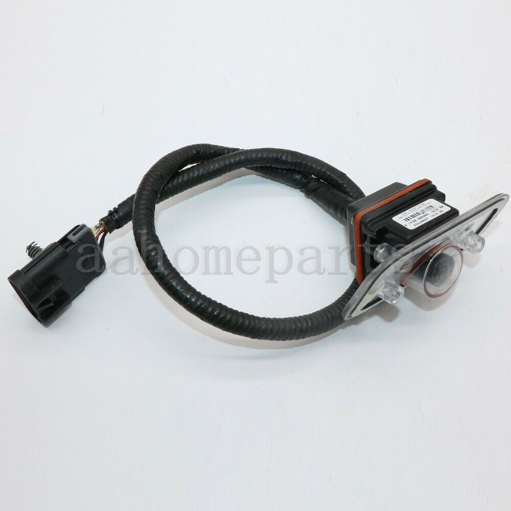

Think bronxteck provide the clues. According to the maintenance manual there are no adjustments,quote "This device requires no programming or setup"
Is this an OEM camera?
Has it just started doing this?
Found this one on eBay is yours the same?
From your picture it's hard to tell if problem is "fogging" or a problem with the CCD array inside.
To me the "block" pattern is indicative of CCD array failure or possibly the display, however I have nothing to compare it too here.
I'd be tempted to remove the camera (see photo) dismantle the clear lens cover (looks like a couple of screws) and give the inside of the cover and external lens-glass a clean as per bronxteck's suggestions.
If that doesn't work, the camera's lens may be removable, if so clean the CCD array's surface and the inside of the lens (note have to be optically/mirror clean)
Failing that check there is actually a 12V signal when in reverse, another possibility is the camera signal is being crippled (water ingress on the signal cable etc) or there's a problem with the mirror/radio display.
I'd be tempted to hook-up a cheap camera and see if that works (assume US is NTSC not PAL, very cheap on eBay)
Pleas keep us updated ....
