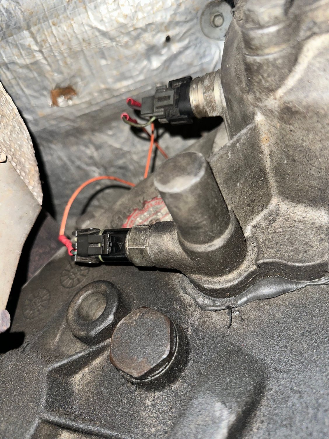

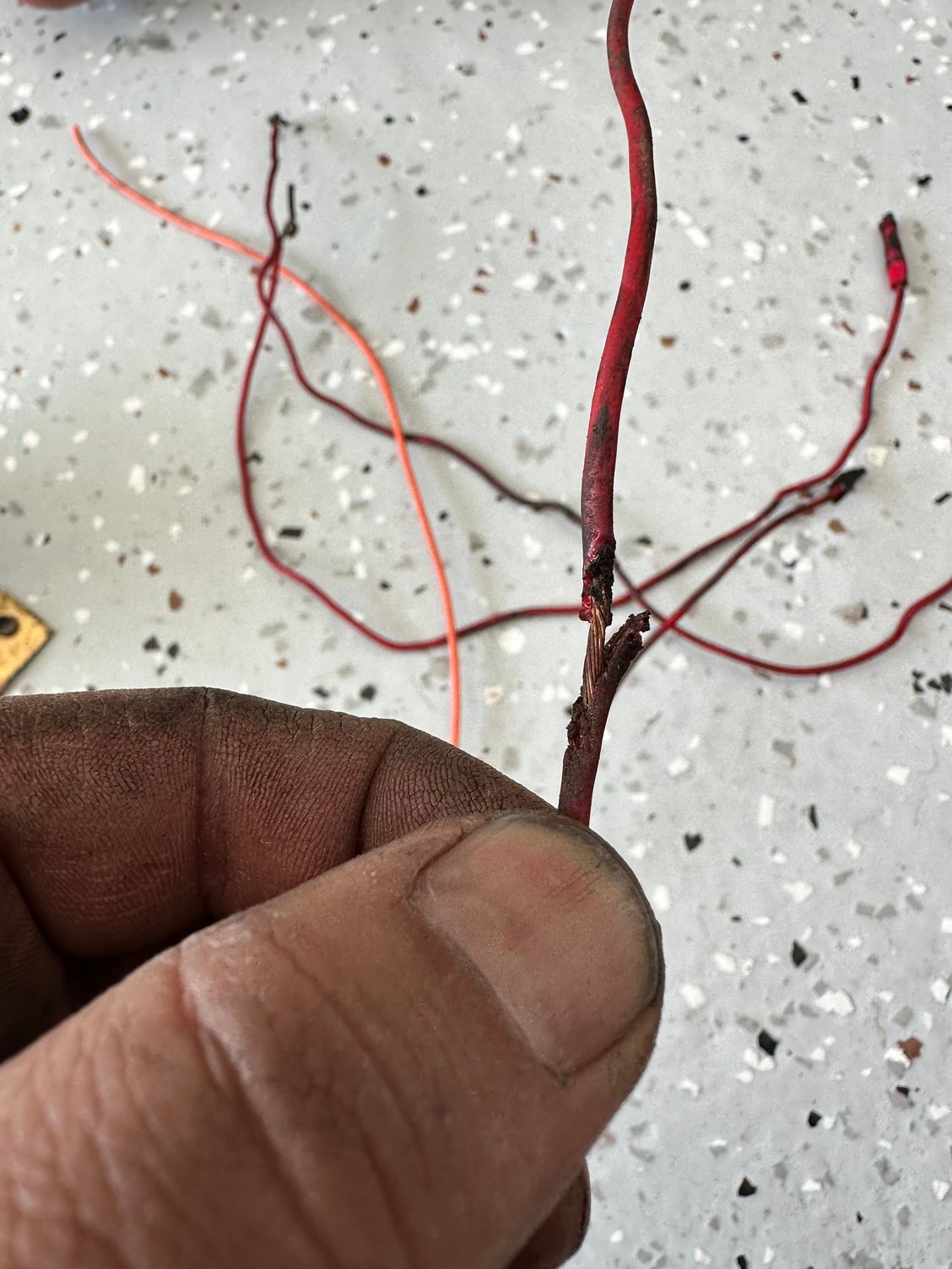

as far as I know its original, nothing looks out of the ordinary or modified. however looking under at the two sensors there was a previous hack job on the wires for those sensors. (will post photos) I temporarily re did the wires to see if it would fix the issue as the old wires were melted and in rough shape I was suspecting a short. (maybe a short happened while I was tinkering with the wires and caused a fuse or the sensor itself to go bad? however it did not fix the problem. also I noticed one sensor on the transmission that is not plugged in and does not even have wires, or a plug, to plug it back.
the only issue is I don't believe the car has this issue when it came to me as I remember going down the street at 60mph comfortably and now I can't even touch 50mph without feeling like the engine is going to blow. it is either a coincidence OR it has something to do with me changing the speedometer?
if I can rule out the speedometer causing this I will go ahead and change both those sensors.
