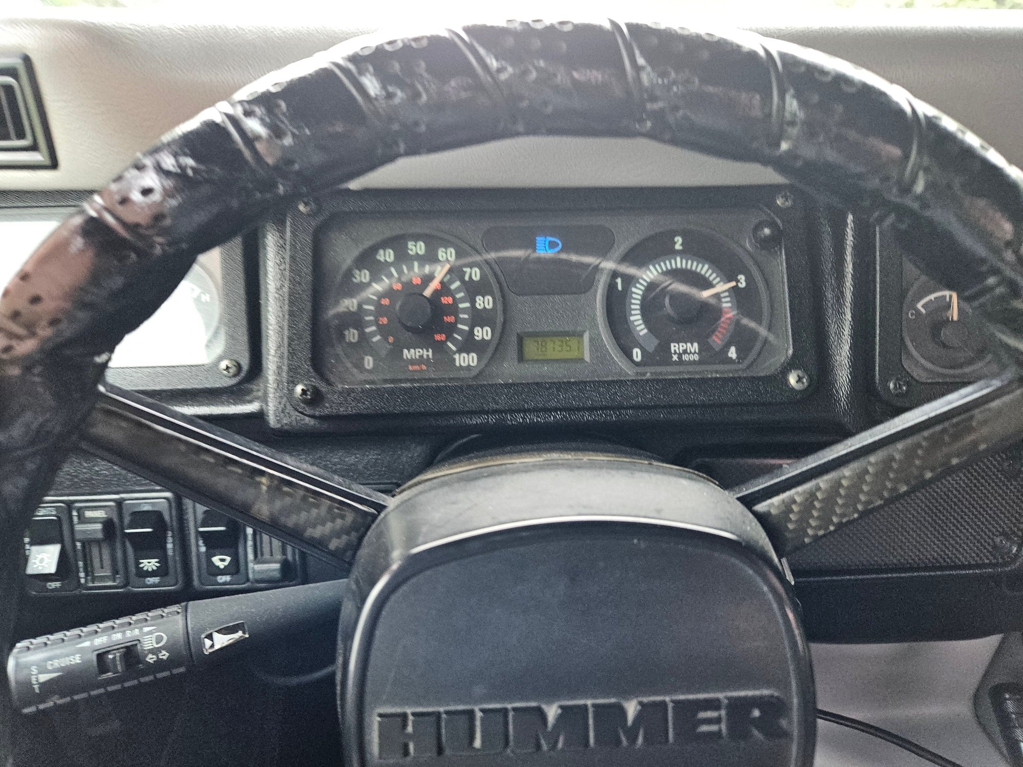

● when I got on the interstate to test out the OD, the truck seemed like it had shifted into 4, and was I running 65 MPH @ 2600 RPM
●about 2 minutes later with light pressure on the pedal on only a slight uphill @65 MPH it all a sudden went from 2600 RPM to around 3000.
●I stopped and checked the fluid level again and at that point it seemed too high
