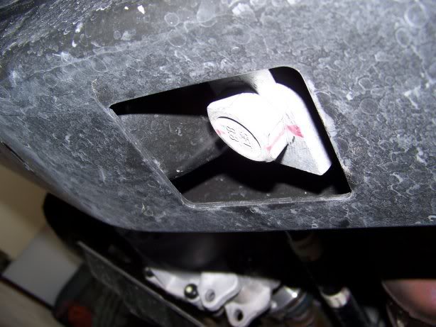

Are they the bolts that are on the cross member by the gas tank?
Old Jun 6, 2012 | 08:42 AM
  #76
Look for this, just like in the pic by the OP, under the front doors.
