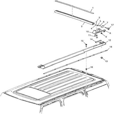

New Hummer owner here, the dealership removed my roof rack and lost the clip that goes into the side rail and tigtens to the **** to secure the roof rack to the truck. Does ANYONE have the oem part number for this? I looked everywhere and cannot find one! Dont want to have to pay for another roof rack because of this.

I know this is old, but does anyone know the part number for those little hooks? Recently had a shop take mine off to do some work and now the hooks are gone. I haven't been able to find them yet.

Based on the picture what number is the part you are referring to?

Unfortunately the 'hooks' were never sold separately, but were always sold with the cross bar support (item #10) above. You can still buy these supports GM 12335652 for the RH and GM 12335653 for the LH; however, it's now more economical to buy the entire cross rail knock off pair from eBay and rob the parts you need.

There is no part number. It is considered part of the black plastic assembly on the end or and entire roof cross bar assembly. The drawing I have is for the option bar with the off road lights so the drawing numbers are different but that part is the same on either.
Item #11 in the drawing is described as
"11 - BRACKET, LUGG CARR MTG(PART OF 9, 13)"

Yeah, that's basically what I've been pulling up too. Figured it was worth asking to see if anyone else had better luck. So, at the moment, options are to contact one of those companies to try and purchase the hooks separately or bite the bullet and grab a new crossbar setup. I guess I need to at least push the shop to try and find the ones that were lost. Thanks for the help guys!
