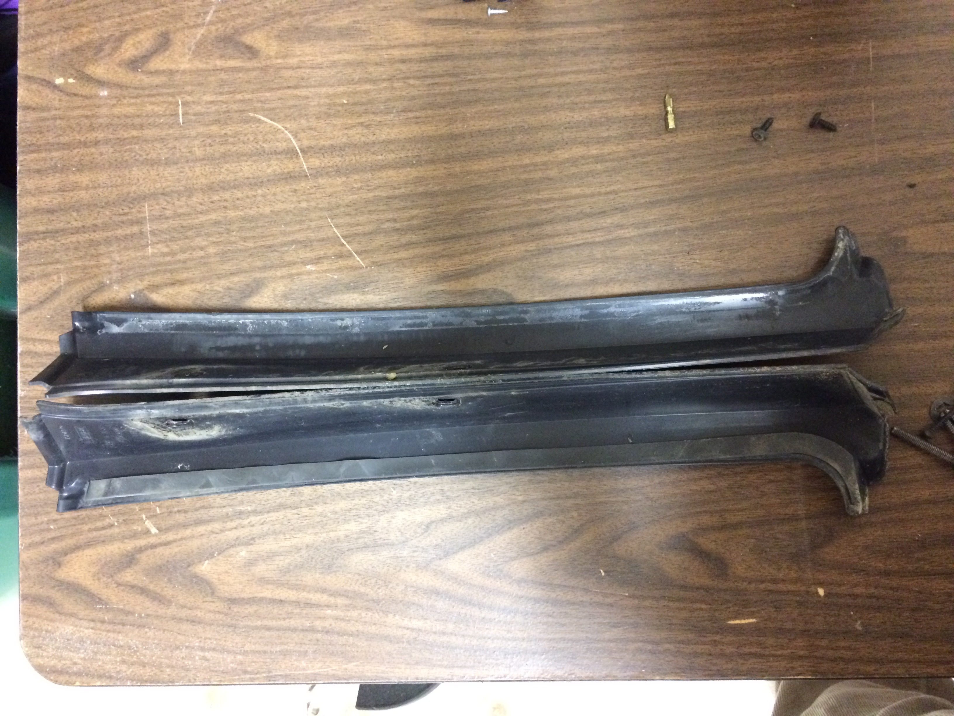

Step 3: Windshield Rattles when Driving-img_2942-2.jpg
Here you will see 3M strip that no longer have their adhesion. Remove the old molding tape and complete by removing any tape residue with Goof-Off. Goof-Off is also great as an adhesion promoter for the new tape.
Step 4: Windshield Rattles when Driving-img_2943.jpg
Apply new tape as shown leaving about 1mm from the edge. In fact you will begin to feel a lip as to where the tape should go. Also, remember to replace the small tape piece on the lower part of the molding as well.
