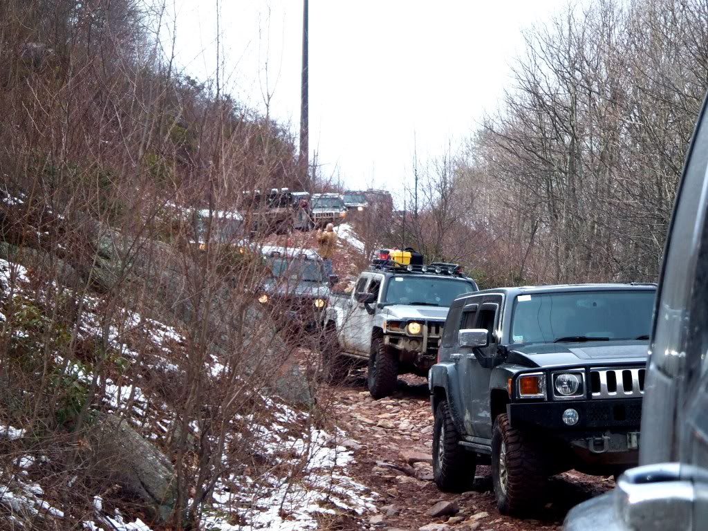

Found some:

It is always a pleasure to see pictures of what these trucks are all about
Thanks Tainter
