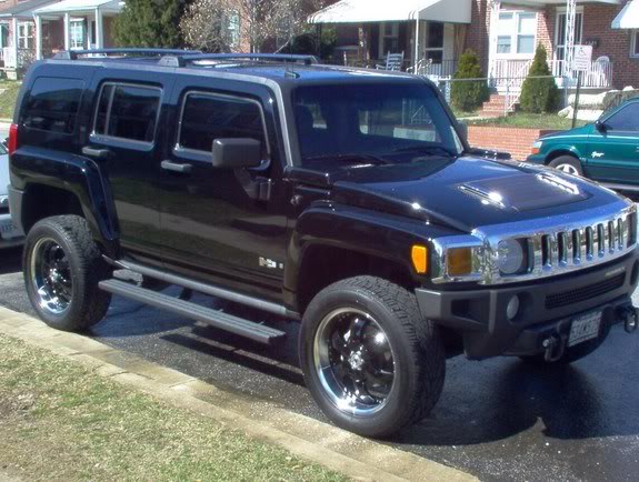

Will these rims and tires look ok on my h3
Old Dec 10, 2011 | 10:59 AM
Josh Weis's Avatar
Joined: Nov 2011
Posts: 25
Default Will these rims and tires look ok on my h3
20inch rims
tires are going to be 275-55-20
Just want to make sure this is not going to look to small.
Cant seem to find a picture online with a h3 like this.

all that matters is overall tire height once mounted.
Old Dec 11, 2011 | 09:51 PM
You will not have much sidewall and the tires will be about 3/4" shorter than the "base" 265/75R16 and almost 2" shorter than the 285/75R16s that came on the Adventure/OffRoad pakcages.
You will be putting on more miles than you actually are driving with the smaller diam. tires you have posted above.
275/55R20 = 31.9x10.8/20
265/75R16 = 31.6x10.4/16
285/75R16 = 32.8x11.2/16
Looks pretty much like a mall crawler with rubber bands for tires to me. Definitly NOT my style.

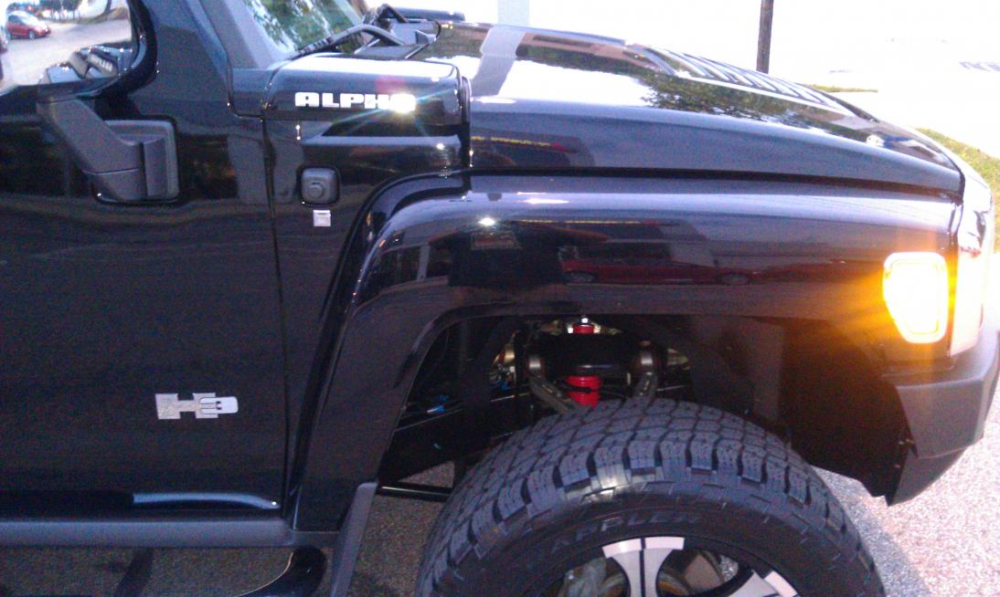

Old Dec 12, 2011 | 05:58 PM
whynot's Avatar
Joined: Sep 2011
Posts: 54
thats what I have on mine
