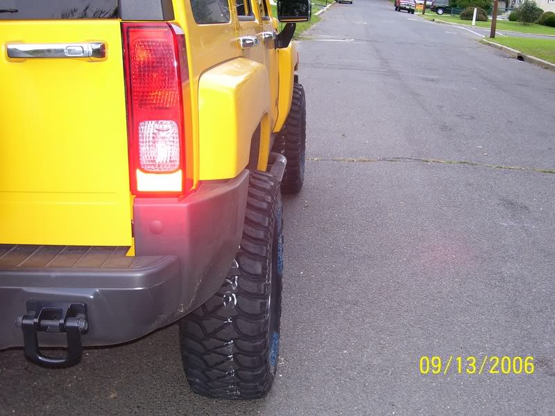

melvnray - it all depends on your offet bro, only way you could possibly hit your tie rod is if you go with more - offset. Stock is -38 as long as you go with less negative you will be fine. Remember more negative means closer to tie rod, less negative or even positive offset means out towards the fender.
There are two main things you need to look at when replacing wheels on an H3, one is if you go with a 16 make sure the inner diameter in the back of the wheel is as big or bigger than stock. H3's us big *** calipers and they could rub the inside of the wheel if you go smaller than stock. The other important thing is to get a large bore size (hole in the middle of rim) Any rim from a 4x4 cevy will fit as long as the offset is less than -38.
here is a +12 offset wheel, it sticks out some but looks better and the truck handles much better now because of the wider track.
