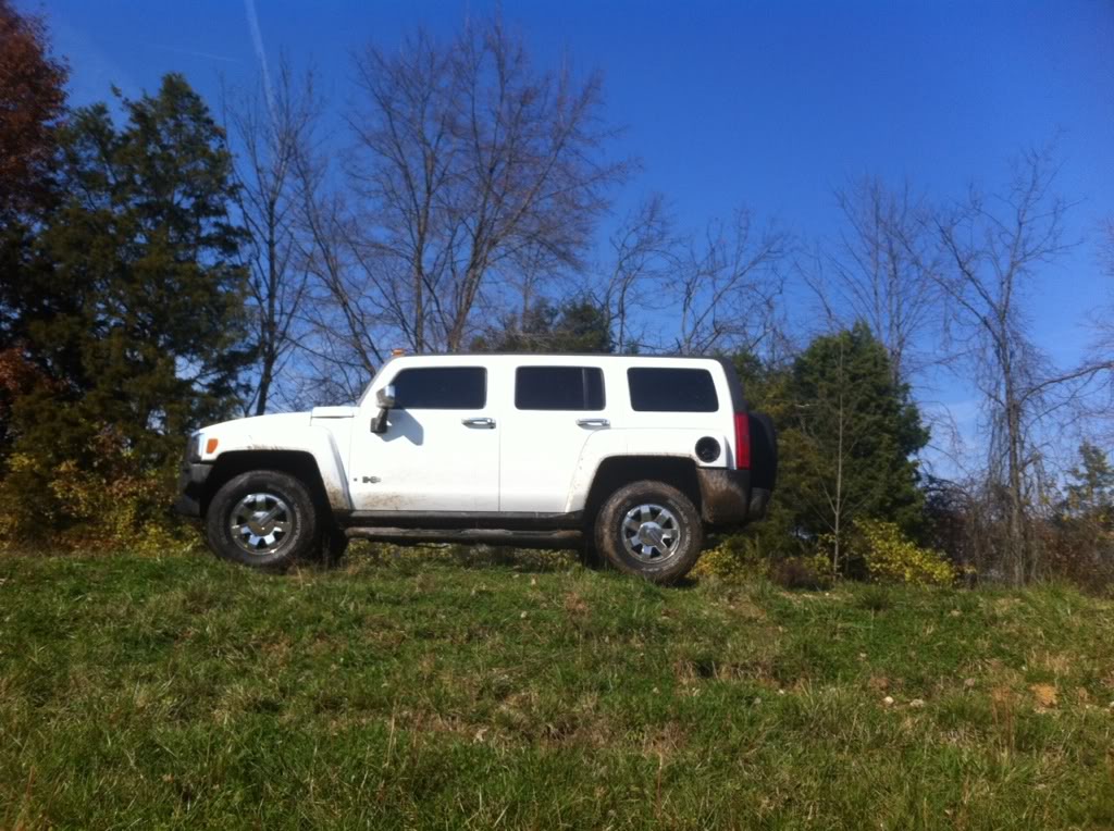

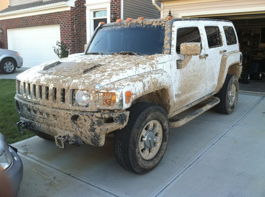

After going off roading this weekend, i have noticed a strange thing happening. Every time i have the wheel turned all the to either side, it wont move (on its own) and i dont know what the deal is. Especially when im backing up. Whenever the wheel is turned, its like it locks up and when i give it gas, it moves but the wheels hop. I cannot figure out the the problem is. Is it maybe a sticky caliper? is it stuck in 4wd (but the buttons show that it is not)? Any ideas or suggestions will be HIGHLY appreciated. Thanks!

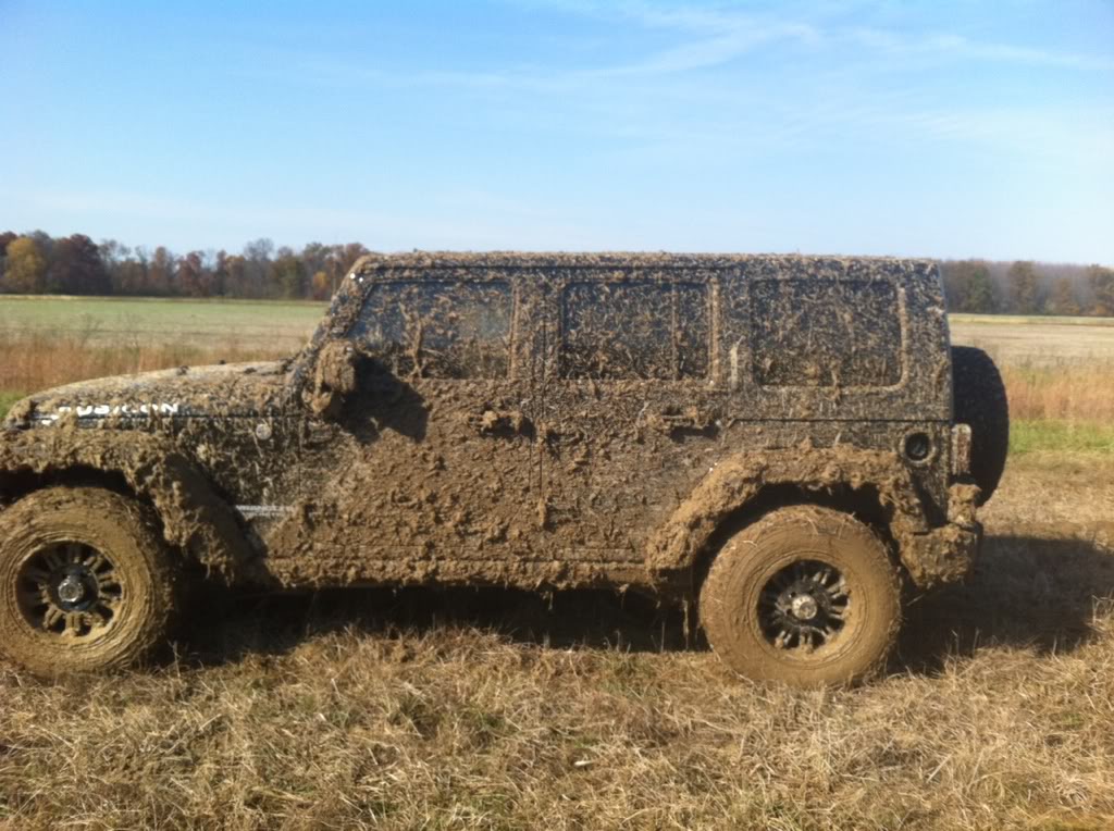

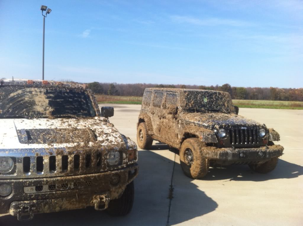

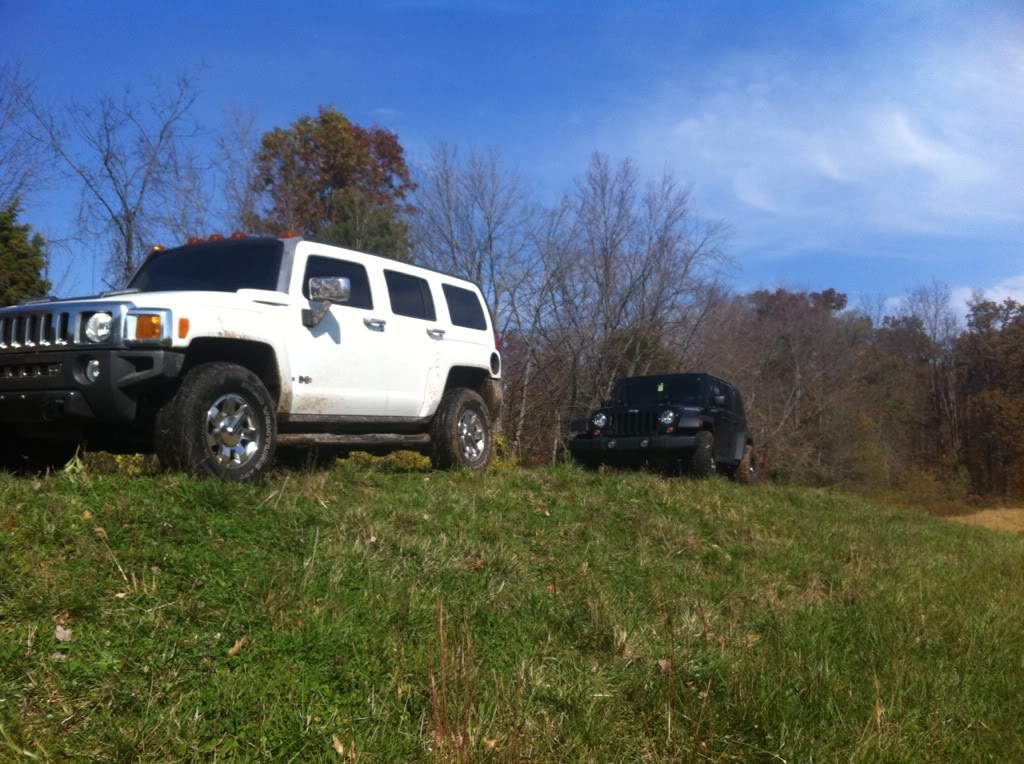

BTW- While mudding i pulled out my buddy's jeep that has mud terrains on it and mine has street tires
here are some pics

the jeep i pulled out

I love the pics!! Our best friends (wife and I) have Jeeps (his and hers). We tease each other back and forth so I can't wait to forward these pics to them! I promised them I'd never put anything derogatory about Jeeps on any of our Hummers, but I never said I wouldn't send them pics that tell the whole story!

i always get teased about having an H3 people saying it sucks and not made for off road, soccer mom vehicle, blah blah blah. I thought it was funny i had to pull him out
