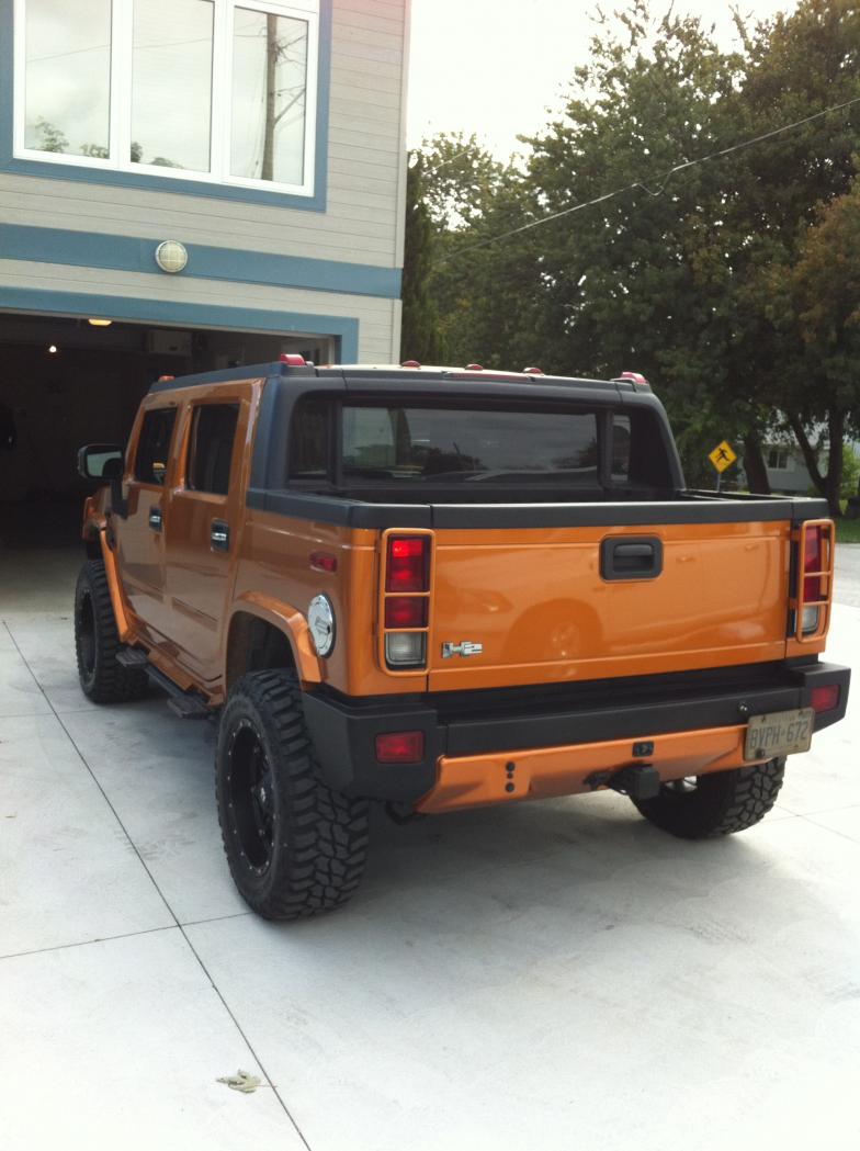

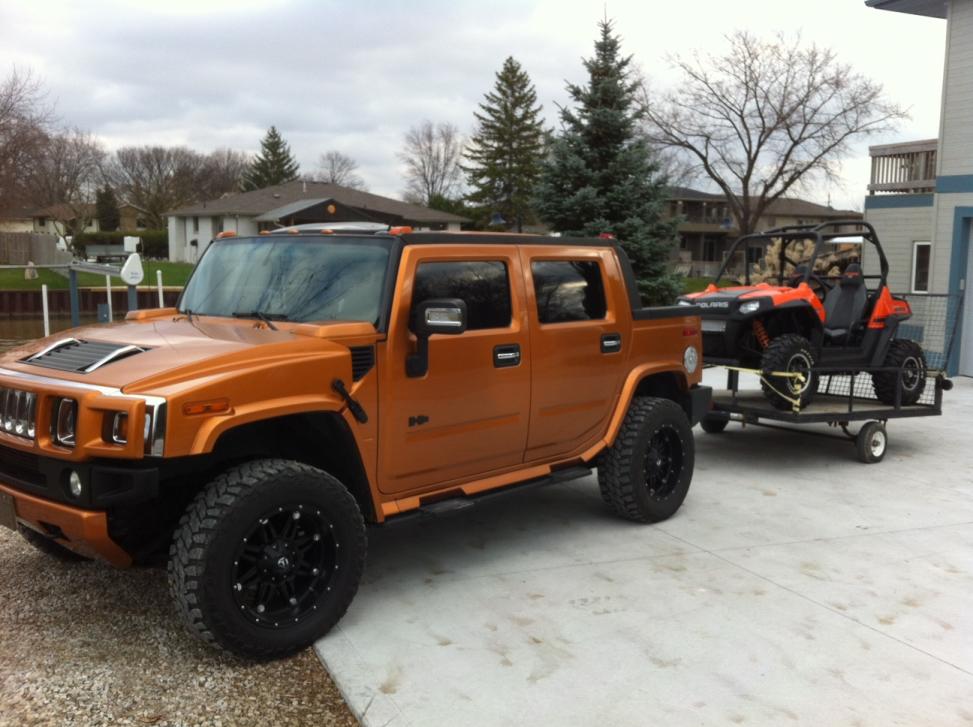

I recently put 20x10 fuel rims with -24 offset on my SUT with a 35x12.50 MT , no rubbing what so ever & I think it looks awesome

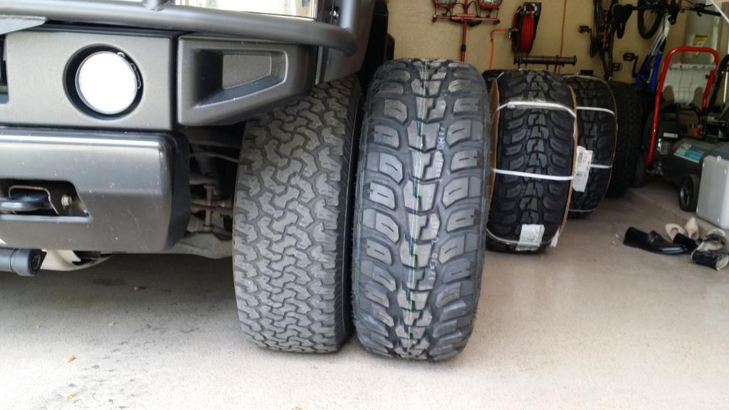

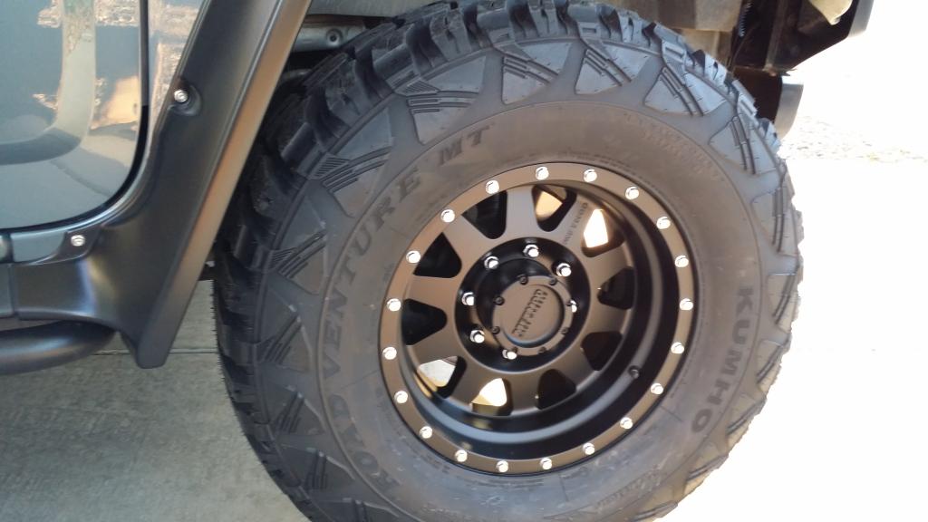

Mine are a -19 offset, 4.25" backspace. I wanted to push the wheels outward to be in line with my fender flares and it was perfect.
These tires fully inflated were much taller than the stock 35" BFG's and there was no rubbing at all.
I still wish I would have gone with 37s because every now and then I think the 35s look too small. Personally 33s would look completely out of place, like you couldn't afford a bigger tire.
For the offset you have to realize what a positive and negative offset is doing to the wheel. Negative is closer to the hub from the centerline of the wheel which pushes the tire outwards. This moves the tire away from the hub, swar bar, etc. I had rubbing on my passenger swaybar with the stock wheels and no more with my aftermarket.
You can easily stay with 35s (that is the stock size) with that offset and you shouldn't have any issues. I don't know what dealer you are going through but check out tirerack.com for options and advice. You can call them and they'll walk you through the whole process.
