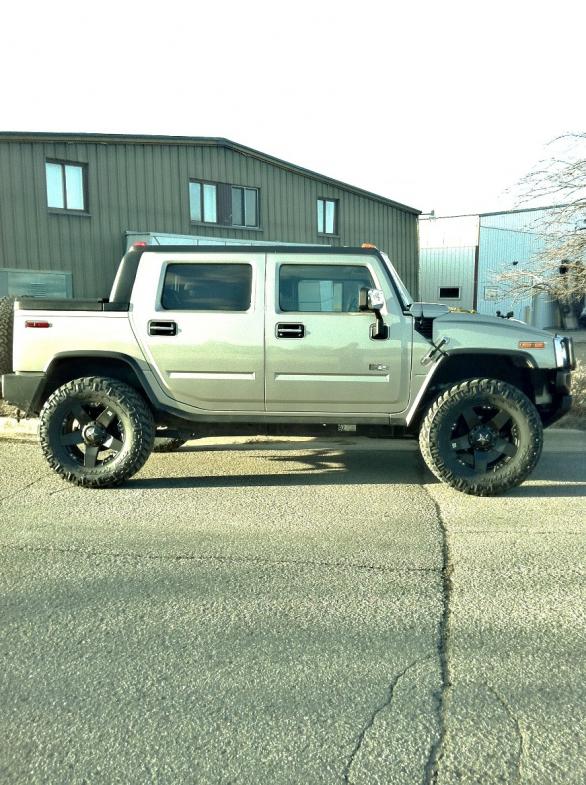

So... I posted this a minute ago on another forum in hopes of finding someone who has possibly tried the same setup.I have been searching through threads to find a definitive answer to the question but have yet to arrive at a conclusion. I recently purchased an 05' H2 SUT with the air suspension in the rear. I was trying to avoid purchasing an SUT with the air in the rear for this specific reason but I got a good deal! I know the setup I want to run and the title says it all. I have already purchased the wheels but have yet to buy the tires due to the indecisiveness of the size. I know I can play it safe and go with the 35" toyo's without having to do much of anything,however, I bought the H2 with full intention of putting the Toyo 37" M/T's on the 22" wheels for that specific look. Has anyone on the forum done this similar setup and if so does the width of this tire rub the rear air suspension sensor??? I've gone over the options of using wheel spacers if neccessary, as well as replacing the air suspension all together. I think I want to avoid replacing or messing with anything that is not broken! The air suspension has never needed service on this specific vehicle and I'd like to keep it untouched as long as it shows no signs of failure. With that being said, what are my real options? Is there anyone out there that has put a 37/13.5 tire on their H2 without rubbing the air suspension?? I will not be doing any offroading, and know I will at least need to turn up the torsion a few inches. Thanks in advance for any comments,advice,or knowledge as I've been searching for the answer for some time now!

I just put 37x12.5x20's on my 05 SUT without any troubles. Looks great and really like the look of the 37" to the 35"...
Attached Thumbnails HELP!!!! 22x9.5 Wheels +10 offset w/ 37" Toyo M/T's + Air Suspension-006rev.jpg

By the way, I didn't want the tires hanging out the side of the truck so I went with 20x8.5 wheels with 10+ offset. Stock offset is 12+ so it's really close.
