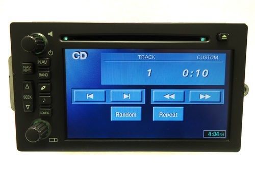

By the way FYR what year its your H2 ??? Mine is a 04 and when i look online i see 3 diferent Nav units. The newer ones 08 09 that wont fit our older trucks and there are other 2 units one with a bulky face looks older and another unit with more of a flat face .. now im wondering if there is a exact part # for the unit that would best fit a 04 ???? The one unit i can pull of the junk yard for 250$ its the bulky one like the picture i posted here ...

My rig is an '07. Mine looks like the one pictured below. They did update the factory Nav units in '08-'09. The part numbers for the factory Nav units are any one of these: 15230099, 10377531, 15800001
It varies depending if your rig has the Bose luxury system or just the deluxe version. Check your RBO sticker inside the glove box and look for the Y91 code.
If you decide to go with the 6 disk, and are looking for one, I can sell you mine cheap. Its just sitting in my garage in a cabinet and works just fine!
