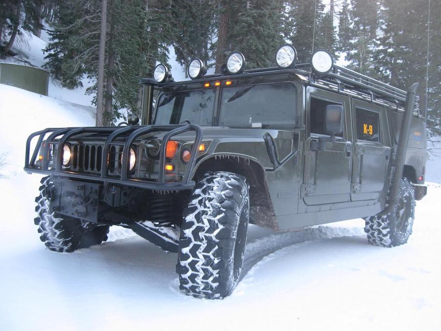

gentleman this is my first post in here , so i will introduce myself first , my name is Eric i am 31 years old from LA.
HUMMER H1 pilot since 2005.
currently i own 3 beautiful H1s
i wanna replace my diesel range rover with H3 that will be used for adventures almost every weekend , , one may ask why don't i use my H1s for that, well the answer will be i do, in fact we plan on global travel with 2 H1s next year. but for now we need H3 to drive on the freeway 75 mph with no problem . wanna stick with hummer brand , and be more comfortable
no questions H1 is the ultimate 4x4, but H3 will be sweet change from my range rover
so your help will be appreciated on what model or year to get.
# 1 it must have lockers
# 2 automatic transmission
# 3 stronger front diffs
# 4 must be 5 cylinder
the rest doesn't mater i really dont understand whats the diferance betwin adventure ,or offroad package , but i want the best package for midium duty 4 wheeling
tnx again very much
Eric
