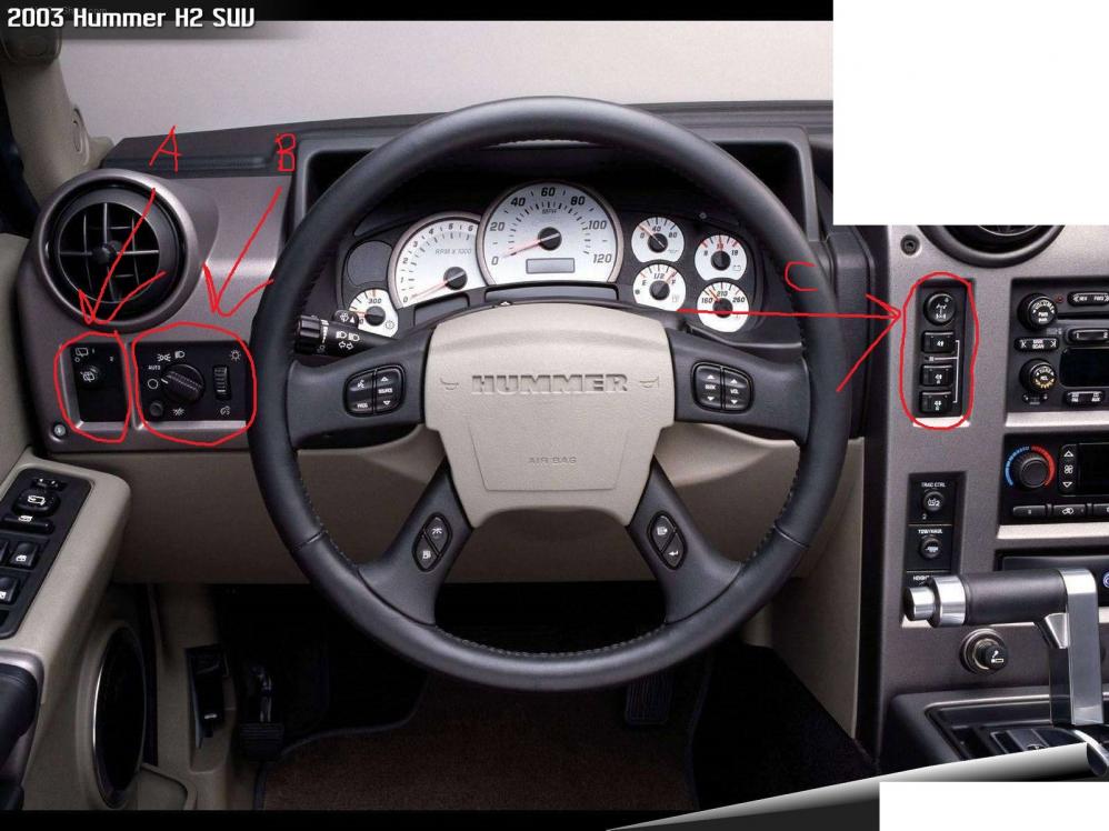

The back lighting on these controls are burnt out.. it is possible to replace the bulb or do I just buy new parts?
attached picture with notes
edit: got A and B.. just need to figure out C now, I've found it's the transfer case shift controls but can't find it for sale yet..
Attached Thumbnails what are these part #'s? 4x4,rear windshield, dome light buttons-hummer-h2_suv-2003-1600-27.jpg

well that was easy.. found 2 of them so far. Just need to figure out the 4x4 buttons now
Electrical-Switch & Relay : Instrument Panel Dimmer Switch
Related Parts
STANDARD MOTOR PRODUCTS Part # HLS1048 {#15176678, 15194803, 15198374, 15206042, 15762307}
Electrical-Switch & Relay : Wiper Switch
Related Parts
ACDELCO Part # D6316E {#15143159}

Part C is #15127829 "Switch- transfer case shift control" at Nalley GMC for $81.14 or GMPartsOutlet for $ 77.89.

If you have moderate soldering skills you can replace the bulbs in everything. I replaced every factory bulb in my dash with LED's for a crisper white.
The 4x4 button packs rarely come for sale on ebay as I stalk ebay regularly.

looks like 19259310 is an alternate part number for the transfer switch, more availability and cheaper
