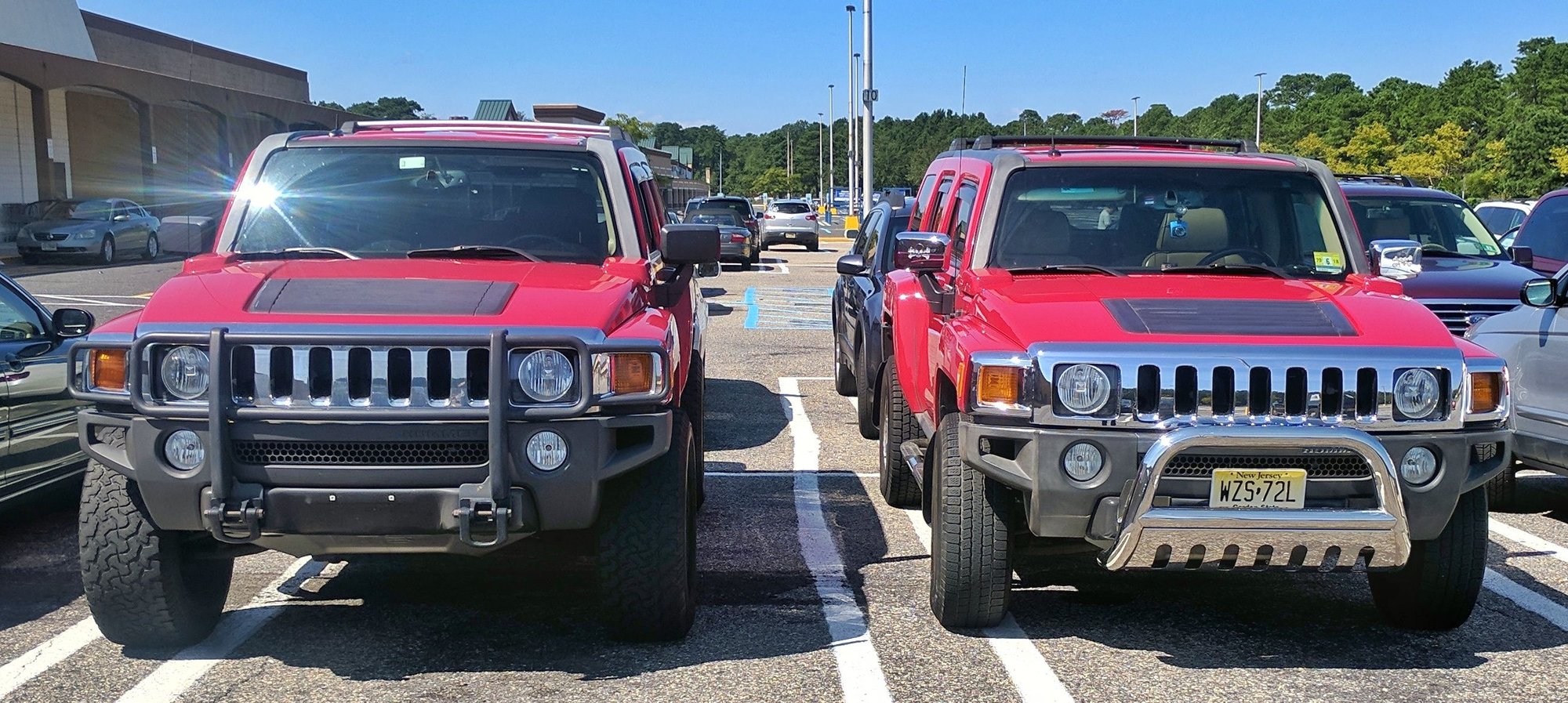

I agree..... The H3 is just the right size that any larger tire gives it the right look . 20" rims may cause issues with rubbing.
I have 18" with 31's , the front is cranked up a couple of inches as mentioned earlier and this alone is enough to make a difference.
Just last week I parked next to one with stock rims, you can see difference in photo. Sits higher than the stock set up without having to go to 20" rims and 35's. Don't think I would go any bigger personally, for fear of losing performance .
