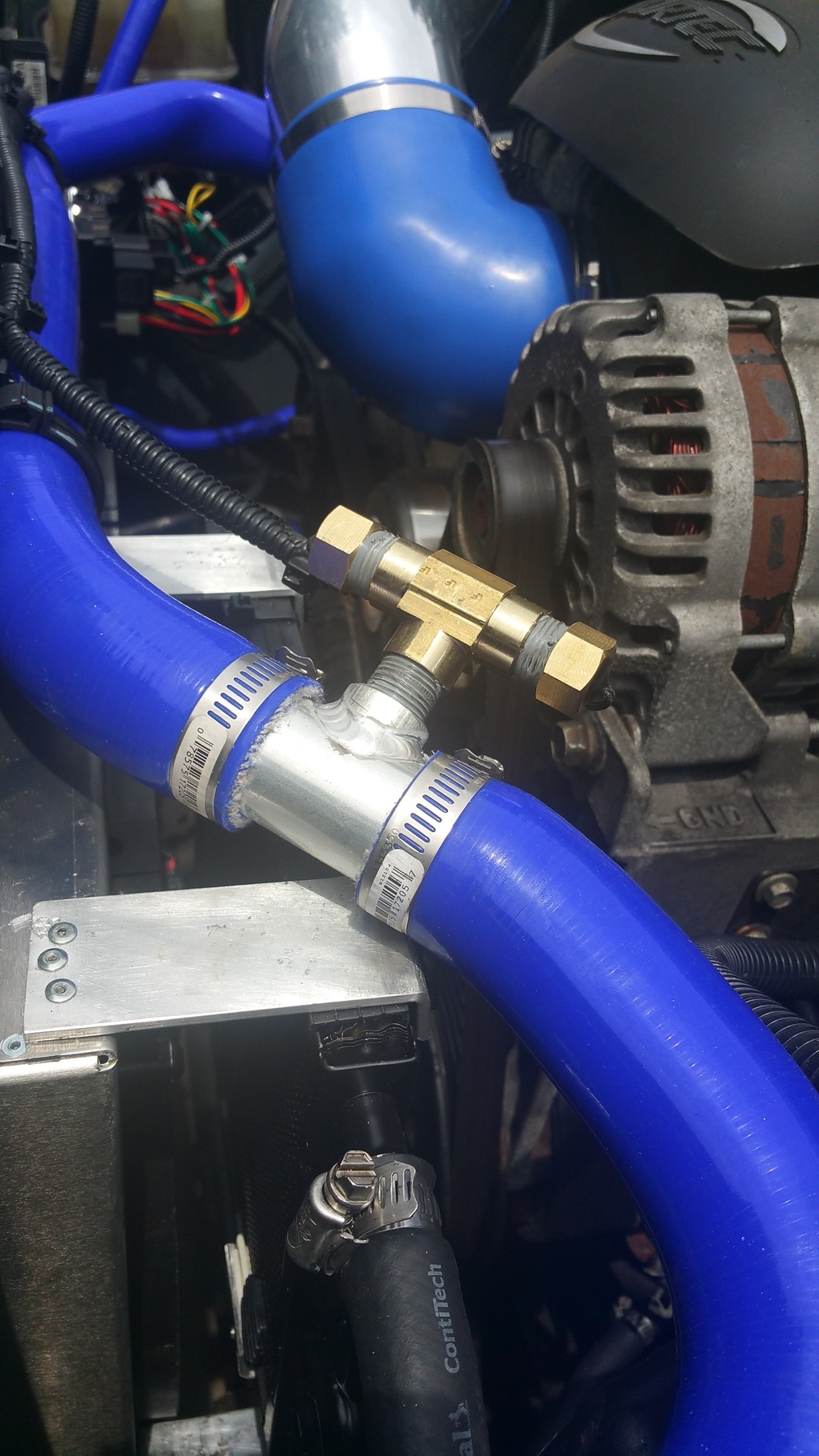

Here is a 3/8 npt T, that i have two 3/8 npt senders in...bought all my brass fittings at home depot..
So thats mean u running 2 sensor with different turn on temp range,rite?
