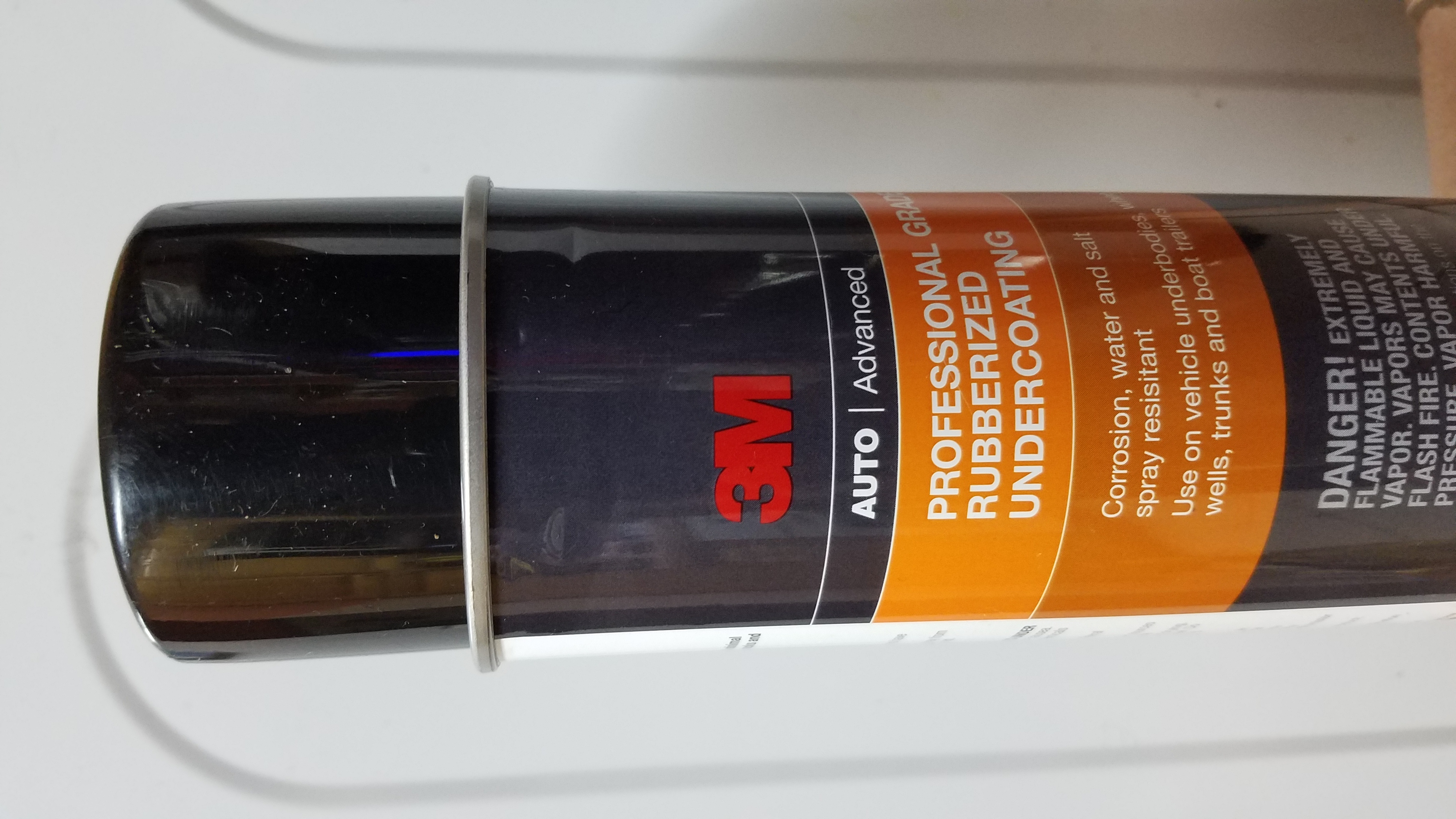

This is what I used . It is. Really good product.
More like a thick rubber paint
No need to do an extensive cleaning
I also sprayed the fender liner to stop some noise
It works but not as the main purpose
You can get it in Amazon
under body rust/spray ??????-20170110_182540.jpg
