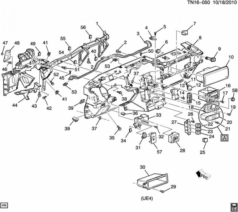

Is there an official name or part number so I can google it and order one?
Old Jul 4, 2013 | 08:22 PM
fyr145's Avatar
Joined: May 2011
Posts: 371
From: AZ
Default part??
See attached diagram and tell us what part number it is so I can get you the number. (if youre talking about the switch)
Old Jul 5, 2013 | 10:59 AM
Godwinrb's Avatar
Joined: May 2013
Posts: 23
I believe it's number 15
Old Jul 5, 2013 | 05:01 PM
fyr145's Avatar
Joined: May 2011
Posts: 371
From: AZ
Default part number
For # 15............that part number is 15127829
