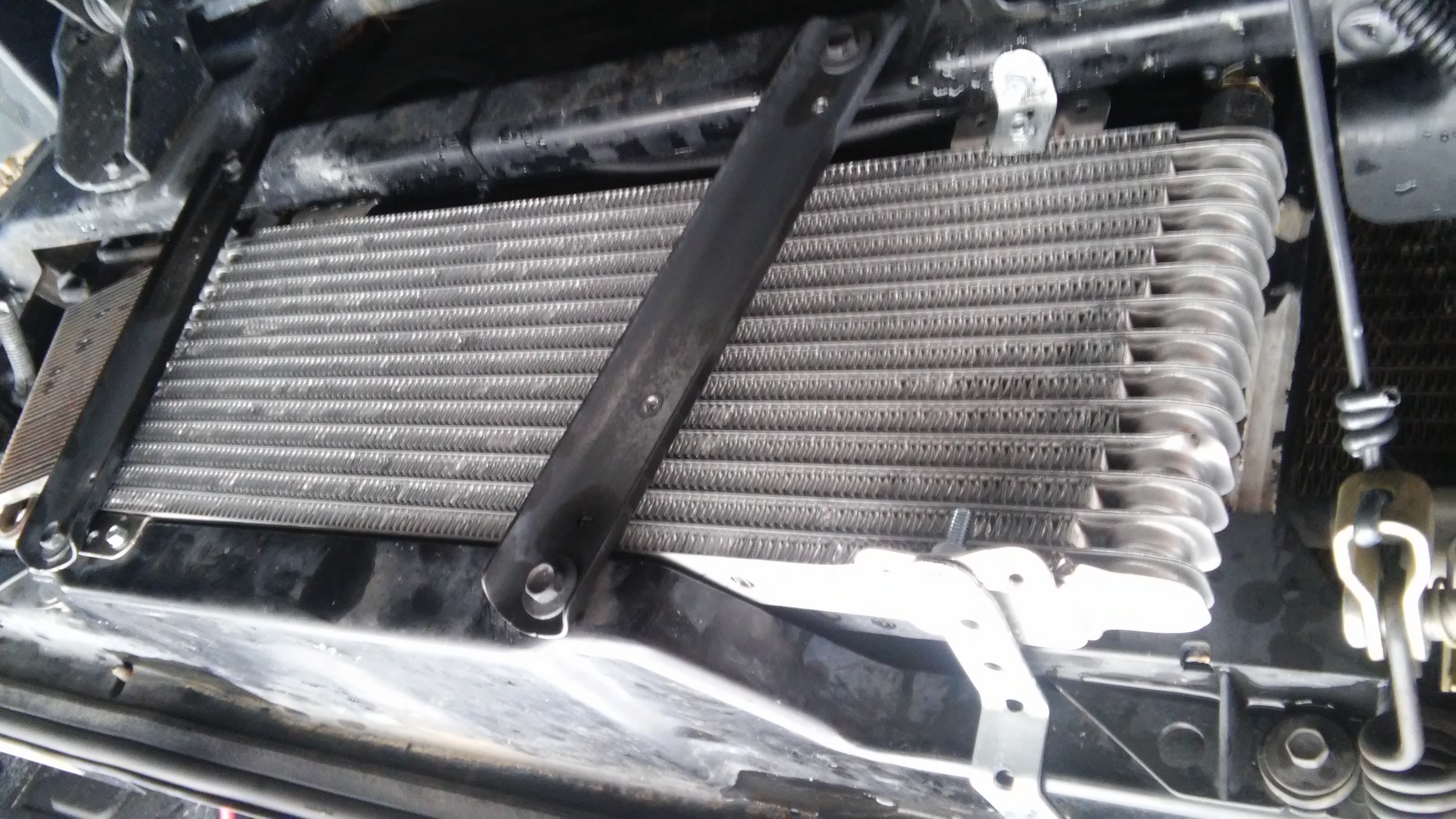

Installed the Tru Cool today. I used the compression fittings shown. I took pics of the part numbers I got from Home Depot if anyone's interested. F-ed up my hands a little but temps went from 200+ to the gauge barely moving.
Attached Thumbnails tru cool trans cooler question-20150829_175203%5B1%5D.jpg   tru cool trans cooler question-20150829_191128%5B1%5D.jpg   tru cool trans cooler question-20150829_191131%5B1%5D.jpg   tru cool trans cooler question-20150829_191141%5B1%5D.jpg

Thanks. So I'll need a bottle or two of that and the fittings from home depot. From what I can find it looks like you have to swing the power steering cooler over and put the tru-cool right up against it otherwise the hood won't close.
I also read you can remove the tranny hoses from the radiator by removing a retaining clip. I just can't find any pictures.
Old Sep 16, 2015 | 03:07 PM
ryaleon's Avatar
Joined: May 2015
Posts: 155
From: West Texas
When I did the install on my 04 I did have to swing the PS cooler over. But when I did it on my 08 I did not. Not sure why. And yes the lines going into the radiator are somewhat shaped like e-clips. You can use a flathead screwdriver to pry them off. There's little room to see or move in that space so if you have the right tools it's probably easier just to cut them.
